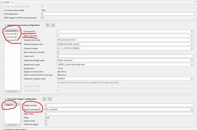

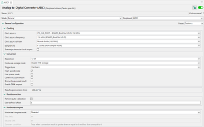

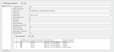

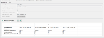

I'm using MIMXRT1170-EVK and I want to setup ADC_ETC/PWM sync mode with Config Tools.
I was using MIMXRT1060-EVK, but with i.MX1170, the appearance of Config Tools has changed, and there unknow terms, and I don't know how to set it like before.
Q.1 Following is the i.MX1060 ADC and ADC_ETC settings. How can I set it i.MX1170?
kenji_0-1635142251769.pngkenji_1-1635142287477.pngkenji_2-1635142312182.pngkenji_3-1635142327687.png

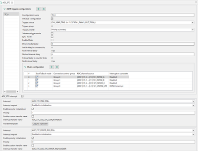

Q.2 Following is the setting screen of ADC_ETC of i.MX1170.
What was called a channel group and conversion control group in i.MX1060 has been replaced by Command ID and Trigger.
I read the reference manual, but I don't know how to set in actual.
I would like to see the setting screen when the ATC_ETC setting of Q1 is applied to i.MX1170.

Hi @kerryzhou -san
I was able to solve by myself.
By enabling the setting of the red frame in the figure below, ADC_ETC worked.

kenji
Hi @kerryzhou -san
I uploaded RT1062(MIMXRT1060-EVK) and RT1176(MIMXRT1170-EVK) board folder and .mex file.
Please check it.
  • What I want to do is to do ADC every PWM cycle for PMSM motor.
  • RT1062 works fine.
  • RT1176 doesn't work as expected.  First, ADC_ETC error interrupt occurs. ADC_ETC_IRQ0 is done every two cycles. ADC is working correctly at ADC ETC IRQ0 interrupt. Also, interrupt timing of ADC_ETC_IRQ0 should be the timing of ADC_ETC_ERR in below figure.
By the way, is there any way to know why ADC_ETC_ERR interrupt happens?
I couldn't find out register that have ADC_ETC_ERR interrupt error flags.
I think, if I can know the reason for the error, it will help me to solve the problem.
