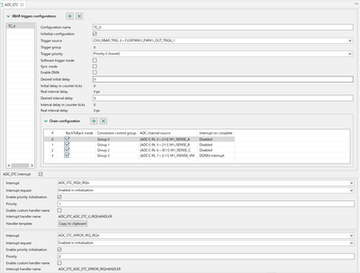

Q.2 Following is the setting screen of ADC_ETC of i.MX1170.
What was called a channel group and conversion control group in i.MX1060 has been replaced by Command ID and Trigger.
I read the reference manual, but I don't know how to set in actual.
I would like to see the setting screen when the ATC_ETC setting of Q1 is applied to i.MX1170.

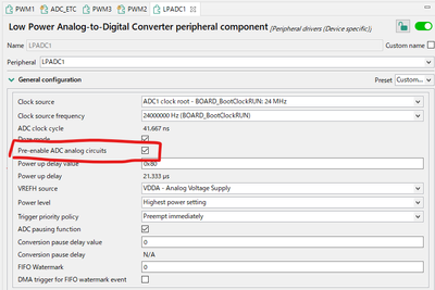

kenji
Hi @kerryzhou -san
I was able to solve by myself.
By enabling the setting of the red frame in the figure below, ADC_ETC worked.

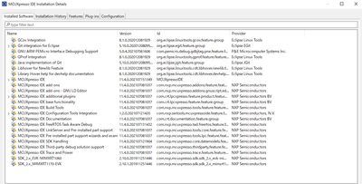

2. What's the CFG version you are using? Or from the MCUXPresso IDE? Which MCUXPresso IDE version.
Please give me more information at first, then I can help you to check more details.

  2. This is the version of IDE I using.

kenji
Hi @kerryzhou -san

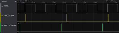

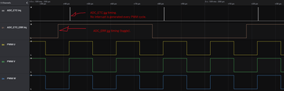

  • What I want to do is to do ADC every PWM cycle for PMSM motor.
  • RT1062 works fine.
  • RT1176 doesn't work as expected.  First, ADC_ETC error interrupt occurs. ADC_ETC_IRQ0 is done every two cycles. ADC is working correctly at ADC ETC IRQ0 interrupt. Also, interrupt timing of ADC_ETC_IRQ0 should be the timing of ADC_ETC_ERR in below figure.
By the way, is there any way to know why ADC_ETC_ERR interrupt happens?
I couldn't find out register that have ADC_ETC_ERR interrupt error flags.
I think, if I can know the reason for the error, it will help me to solve the problem.

The following is the manual and setting screen of i.MX1170 regarding ADC_ETC.
  1. How set the conversion trigger of chain configuration?
  2. Is the trigger source and conversion trigger the same or different?
  3. Is segment and command ID the same or different?
