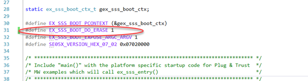

Actually the mem size should change, but I am not sure if you have enabled the following definition so the application deleted all custom defined secure objects from the beginning of the demo.
Kan

namht
I call ex_sss_boot_factory_reset() → Se05x_API_GetFreeMemory() → InjectCertificate → Se05x_API_GetFreeMemory() .
Log :
App :INFO :mem=32767
App :INFO :Inject certificate example
App :INFO :Injecting ECC certificate at 0x00000014
