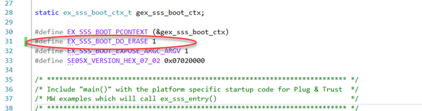

I tried demo of "se05x_InjectCertificate" for save data to SE050 and "se05x_GetCertificate" for read back this data from SE050 successly. Howerver, my secure data can be leak if anyone try  "brute force" keyID for get data, rights?
And, I tried a demo of "se05x_Minimal" for gets available memory from secure element. I see before and after Inject Certificate, Se05x_API_GetFreeMemory() return pfreeMem = 32767. Why available memory of SE050 not change?
2,108 Views
Kan_Li
Hi @namht ,
Yes, it is possible so we recommend binging with your host in real application, please kindly refer to https://www.nxp.com/docs/en/application-note/AN12662.pdf for details.
Actually the mem size should change, but I am not sure if you have enabled the following definition so the application deleted all custom defined secure objects from the beginning of the demo.
Kan

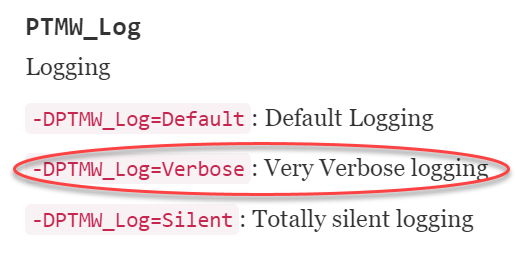

Kan_Li
Hi @namht ,
Is it possible to turn on the verbose log level? so I may have the APDU command log for analyzation.
Kan
