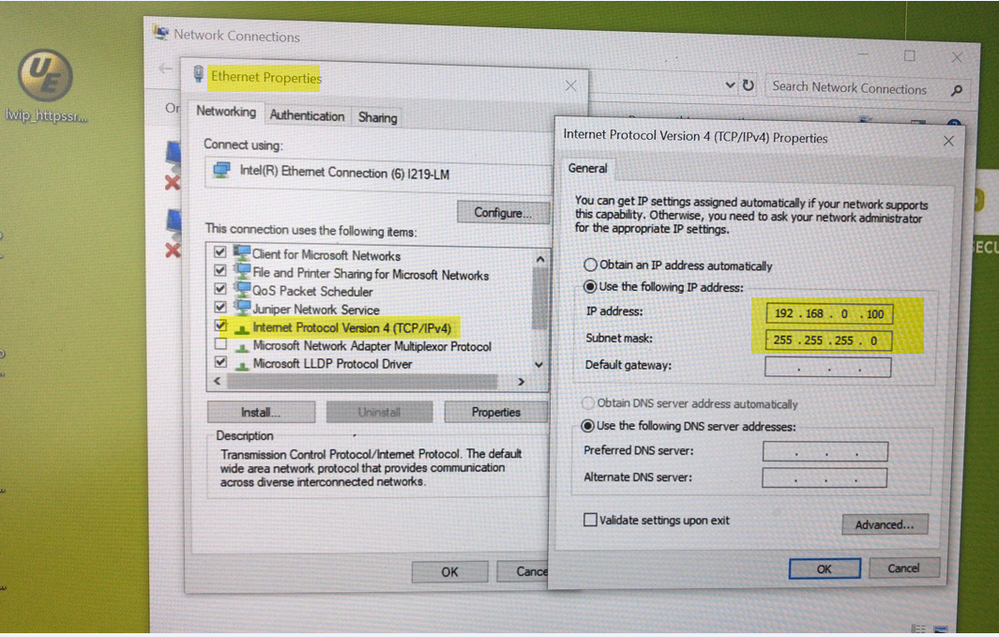

3. Find a PC, configure your PC Ethernet properties like this:
4. Find an Ethernet cable to connect the PC and your board, power on your board.

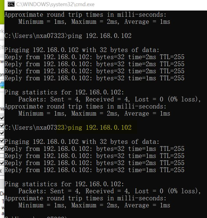

5.You can ping your board
No lost

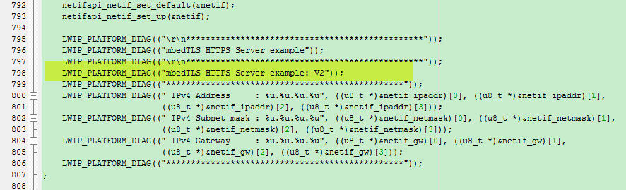

Please note, to identify the evkmimxrt1060_lwip_httpssrv_ota_freertos version 1 or version 2, I add the version printf code in the evkmimxrt1060_lwip_httpssrv_ota_freertos project

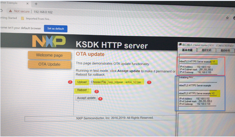

7. Now, open a brower, you can use the chrome, type https://192.168.0.102
  Then you can upload the new V2 (when current is V1 )or V1(when current is V2) evkmimxrt1060_lwip_httpssrv_ota_freertos .bin file
   This is my test result:
You can find, when my current is V1, after I upload the new V2.bin app, then the new printf result is V2, it means my http ota is working.
Vice-versa, when my current is V2, I can upload V1 version, then you will see the new printf result is V1.
Now, answer you new questions, your understanding is correct, OTA is used to update the self app code, in this example, evkmimxrt1060_lwip_httpssrv_ota_freertos is the app, it use the ethernet to update itself code, that's why you will find the new printf is V2, or V1.
