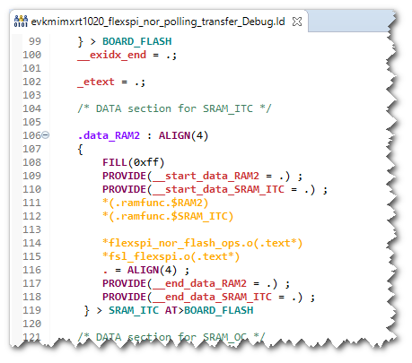

There are many, many responses to this question, and there are many, many issues arising.
BUT going back to your first question, you want to place all code (.text*) from a C source module into ITCM. That is very easy to achieve, using the linker file.
Take a look at the v2.7.0 SDK example project evkmimrt1020_flexspi_nor_polling_transfer (I assume it is the same for your RT1060 equivalent in your SDK). The project is linked for XIP execution from flash, and then erases and programs the flash memory. Obviously the code cannot be running from flash, and so all of the functions from driver API module fls_flexspi.c and flexspi_nor_flash_ops.c are placed into ITCM (that is SRAM_ITC alias RAM2 in this project) by the linker. But the main() is located in flash.
Does this help you?

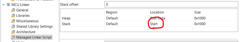

If the issue is because of the push instruction at the very first of ResetISR, SP is pointing at 0x20040000 which is nothing assigned at that time. FlexRAM is not configured yet, but the push instruction access to 0x2003FFFC and 0x2003FFF8.
The workaround doesn't help to solve this issue since SP is already pointing at 0x20040000.
Now I understand why debug mode works. The script changes FlexRAM configuration before loading the software, so when it comes to execute the very first push, RAM is already mapped at 0x20040000.
Is there any way to prepare ResetISR without the push?
I found how to change the stack location on the IDE. The default value is 'End' but I can set 'Start' so that the stack is at 0x20010000 which is always available. Is there any side effect to change the location from 'End' to 'Start'? With this modification, it is working now.

TomohiroInoue
Hi kerryzhou‌, takashi.kashiwagi@teac.jp‌,
Is there any side effect to change the stack location from 'End' to 'Start'?
Tom

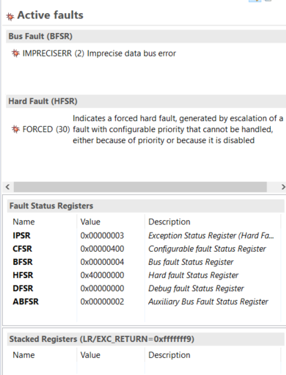

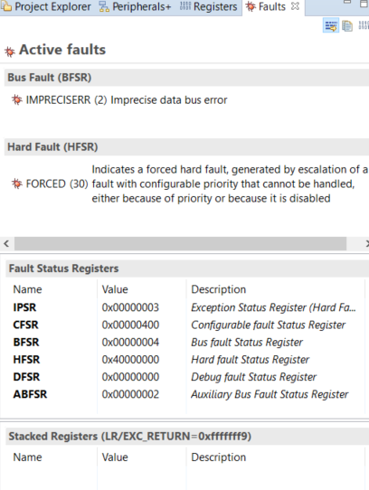

Takashi_Kashiwagi
Senior Contributor I
Hi Inoue-san,
According to ABFSR, Asynchronous fault on DTCM interface has been occurred.
3.3.9. Auxiliary Bus Fault Status Register ARM Information Center
Please check which instruction caused Hard Fault when you executed "step in".
Is the instruction  trying to write to an invalid address?
T.Kashiwagi
7,160 Views
TomohiroInoue
Hi Kashiwagi-san,
I am not quite sure if there is any difference between Step Over and Step Into here since the very first instruction is this:
__asm volatile ("cpsid i");
I did Step Into (F5) on that and got the same Hard Fault with additional window as below.
Tom Inoue

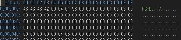

TomohiroInoue
Hi Kashiwagi-san,
After loading "hello world" example, I could use Debug Mode only one time.
Below is what I can see on the debugger. This matches with the .bin file.
0x60000000 46 43 46 42 00 04 01 56 00 00 00 00 01 03 03 00 FCFB...V........
0x60000010 00 00 00 00 00 00 00 00 00 00 00 00 00 00 00 00 ................
0x60000020 00 00 00 00 00 00 00 00 00 00 00 00 00 00 00 00 ................
0x60000030 00 00 00 00 00 00 00 00 00 00 00 00 00 00 00 00 ................
0x60000040 00 00 00 00 00 04 06 00 00 00 00 00 00 00 00 00 ................
0x60000050 00 00 80 00 00 00 00 00 00 00 00 00 00 00 00 00 ................
0x60000060 00 00 00 00 00 00 00 00 00 00 00 00 00 00 00 00 ................
0x60000070 00 00 00 00 00 00 00 00 00 00 00 00 00 00 00 00 ................
0x60000080 EB 04 18 0A 06 32 04 26 00 00 00 00 00 00 00 00 ë....2.&........
0x60000090 00 00 00 00 00 00 00 00 00 00 00 00 00 00 00 00 ................
Tom

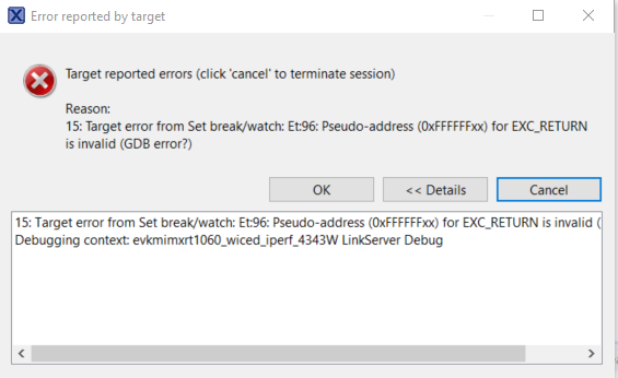

TomohiroInoue
I could put breakpoint on ResetISR. When I start the debugging, Eclipse shows green highlight on this line:
I could do step over with "hello world" example, but I could't with my project. After clicking "step over" button once, Eclipse shows this.
Any suggestion to try something?
Tom

5. I learned from MCUXpresso_IDE_User_Guide.pdf that I can put those object on SRAM_DTC. Can you let me know how I can put those objects on SRAM_ITC using .ldt files? If I modify main_data.ldt, then everything goes to SRAM_DTC, but I would like to use SRAM_ITC since this is instruction code.
Answer:
   If you want to use the SRAM_ITC, you can move the SRAM_ITC to the first one in memory configuration editor.
You can try it on your side.
If you still  have questions about it, please kindly let me know.
