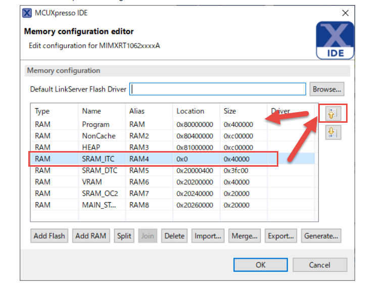

  2. Static configuration says FUSE FlexRAM bank configuration. Is this really using Fuse so that this can be done only one time and you cannot change the configuration?
Answer:  Just as T.Kashiwagi has replied you, you can use  IOMUXC_GPR_GPR17 register to modify the configuration in run time.
       But after boot, the configuration will use the fuse data, but please note, fuse area just can be modified one times. So, normally, in your design phase, you can modify the register to realize it, but in the product phase, you can modify the fuse.
5. I learned from MCUXpresso_IDE_User_Guide.pdf that I can put those object on SRAM_DTC. Can you let me know how I can put those objects on SRAM_ITC using .ldt files? If I modify main_data.ldt, then everything goes to SRAM_DTC, but I would like to use SRAM_ITC since this is instruction code.
Answer:
   If you want to use the SRAM_ITC, you can move the SRAM_ITC to the first one in memory configuration editor.
You can try it on your side.
If you still  have questions about it, please kindly let me know.
