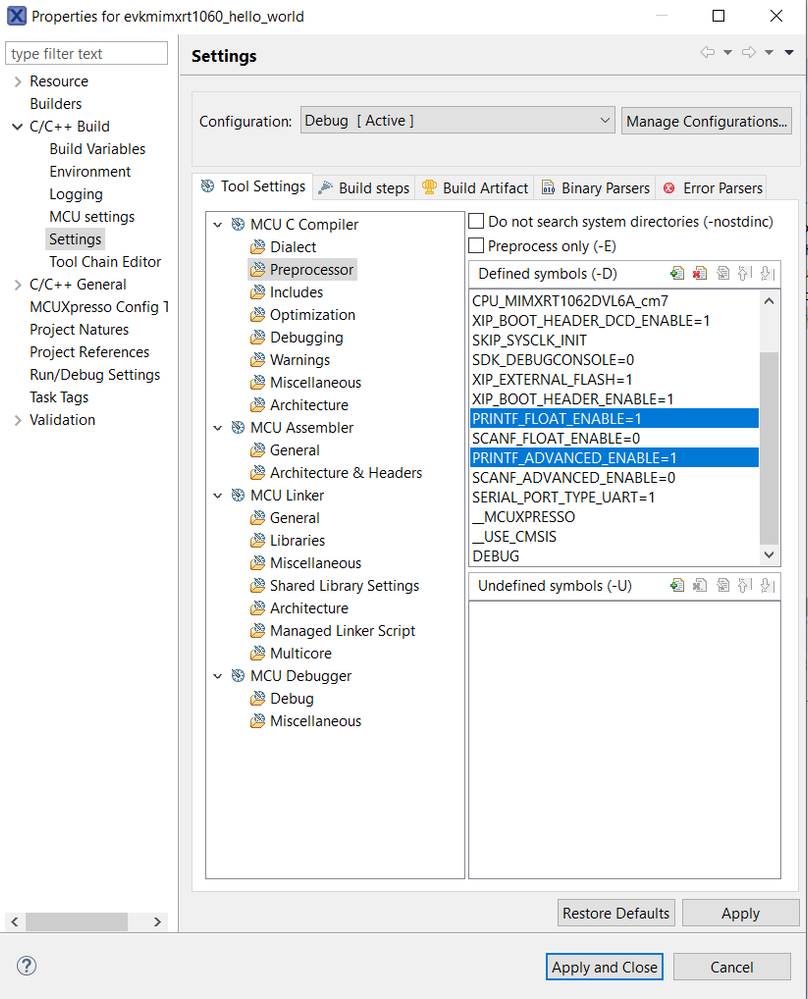

If I use
PRINTF("negative float test = %f", -1.234);
to print the negative float point number, I got the positive value from console, like
"negative float test = 1.234000"
Can you help me to fix it to show the real negative value?
p.s. define PRINTF_FLOAT_ENABLE=1

Hi Felix,
Negative floating point values can be printed by opening the Project Properties and defining both “PRINTF_FLOAT_ENABLE” and “PRINTF_ADVANCED_ENABLE” to 1 in the Preprocessor settings. This is shown below using the hello_world SDK example project.
Let me know if this solution works for you. If not, could you provide more details on your environment to help find a solution?

Hi Kaleb,
Thanks for your right answer.
