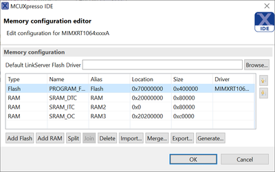

I followed this post https://community.nxp.com/t5/i-MX-RT/FlexRAM-and-Linker-Problem/m-p/990512 , specially from JackKing and intended to make full use of SRAM_DTC as below.
My usage of SRAM_DTC is about 27%, bigger than default 128K, it compiles fine,
Memory region Used Size Region Size %age Used
PROGRAM_FLASH: 208472 B 4 MB 4.97%
SRAM_DTC: 144908 B 512 KB 27.64%
SRAM_ITC: 0 GB 512 KB 0.00%
SRAM_OC: 896 B 768 KB 0.11%
but when it runs, it comes up with a hard fault.
Help, please, i need to make full use of the RAM as it is a bigger project.
Regards!

I am looking for an simple and successful example of RAM configuration, as my project requires more DTC RAM, browsed several posts and haven't found any marked as solution. Now the project is moved to RT1024, and the RAM is even smaller there, so I urgently need to configure the useful RAM - DTC to at least 128k. Where shall I set OMUXC_GPR_GPR17 described in AN12077? and with what kind of memory configuration pls?
Regards!
Ping

To change FlexRAM sizes the following sequence is used:
1. Write memory type sizes (rounded up to power of two sizes)
IOMUXC_GPR_GPR14
2. Write the sector configuration (2 bits per sector defining whether off, or which RAM type it is assigned to)
IOMUXC_GPR_GPR17
3. Switch over from the setting configured by eFUSE to that configured by GPR17 by setting the FLEXRAM_BANK_CFG_SEL_CFG flag in IOMUXC_GPR_GPR16
Details are also given in the application note.
Mark

shall i do this first in main.c? or is it too late?
Regards!
Ping
3,787 Views
mjbcswitzerland
Specialist V
Ping
I do it on the fly (preserving stack) but that is a special technique requiring observing additional rules (with special code to do the switch and keep the processor stack at the same address location).
Generally it needs to be done before RAM is being used for anything (no variables, no stack and not within a subroutine that needs to return). Basically it is best to do it as very first instruction executed at the reset vector to be sure that it is always safe. That is, very first thing in ResetISR() if you use SDK code.
Mark

Thanks, Mark
It is working!
