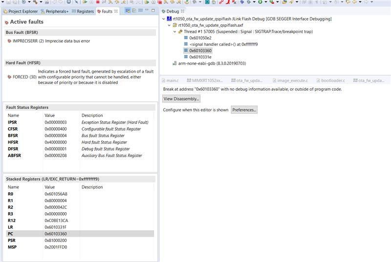

I have created an L2 bootloader (modified from an NXP provided "OTA Bootloader") that will look for various images in QSPI flash, validate them, and decide which one to boot based on an A/B/Factory partitioning scheme.
The bootloader is what is loaded by the BootROM and is XIP from flash.  The images I want to boot are also in QSPI and I want them to be XIP as well.
I have the following setup:
RT-1052
L2 bootloader runs, can find the images in flash, validate them, and "jump" to their respective start addresses.
Vector table "seems" correct for image I'm attempting to jump to, the stack pointer is set to 0x20000000 (SRAM DTC), ResetISR "appears" to be at the correct memory location.
Functions are below for jumping to application.

Issues:
I get an Imprecise Bus Error hard fault after the jump.

I figured out my issue.  My application required SRAM and a DCD but the bootloader did not.
When loading an application that depends on a DCD I needed to change my bootloader to use that DCD, then change the bootloader to skip SYSCLK_INIT (since it is now using a DCD).  The bus fault was because I wasn't skipping the SYSCLK INIT in my bootloader.
This is resolved!

From what I'm seeing my application has the hard fault as soon as it tries to copy the 'data' section to SRAM.  It's an imprecise bus fault so I'm not 100% sure this is where it is happening, but my program counter in my application is at the "data_init" function called within the startup routine of the application where it is copying the application's data section to BOARD SRAM (not the internal SRAM like ITC, DTC, or OC).

Set a break point at the line that you know will fail and switch to disassemble mode. Watch which register is used as a pointer and the value that it has before failing. It sounds as though it will point to the SDRAM area.
Try viewing this area in a memory window - if it can't be viewed it will presumably mean that the SDRAM interface hasn't been configured. Check SDRAM controller's registers to see whether they haven't been set up at all or whether they have been set up incorrectly.
If it can view it double check the range that the data is being initialised in to be sure that it matches the expected SDRAM range.
If you have no SDRAM setup in the loader's CDC you can add initialisation code in the application to do the same before it starts accessing the SDRAM.

greg_nowak
Currently it is "jumping" to the reset ISR in my Application but I get the hard fault somewhere in that function.  The hard fault occurs before the "main" of my jump to application is called.  I tested this by putting a while(1) loop at the top of my application main.
There are a couple things I'm struggling to understand.
1.  My bootloader uses DTC and ITC sram for execution.  When I hand over control to my application does it do what it needs to do with those memory regions automatically?
2.  I'm disabling D and I caches in my bootloader prior to making the jump, but it is still hard faulting.
Because it is an "imprecise bus error" I don't get a solid picture of what specific function is causing the issue.
