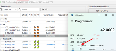

We are using MIMXRT1064 & MIMXRT1062 controller in same project (depending on availability). As both the chips are almost same and the code runs from internal ram, there is no need to compile the Application code separately for both chips. But during the program execution we need to know on which chip the code is running.
In Kinetis series there is a register called "SIM->SDID" which give information about chip itself, is there something similar in MIMXRT series also available?

Hi @ishwarlal ,
I would like share you some information which I got from internal team at NXP.
please try to read fuse value by below shadow register, it has the different value in bit20 between RT1062 and RT1064.
I did a test, I can read  this fuse value, it has the different value in bit20 between RT1062 and RT1064.
Wish it helps you.
