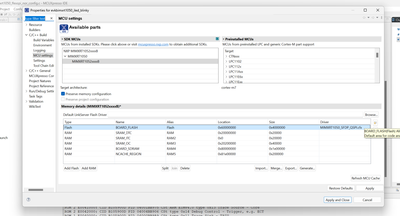

    I have followed the following application note provided by nxp AN12183 and AN12108,
1. R356, R361 - R366 are removed and R153 - R158 resistors are weld by using 0 ohm.

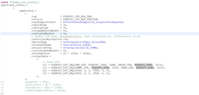

2. And i have changed flexspi nor configuration as follows,
3. I have changed linkserver flash configuration also like below,

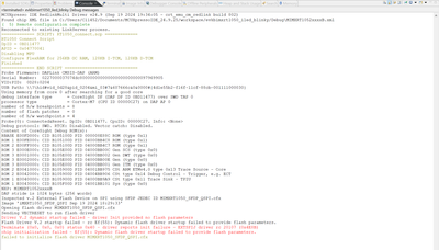

After doing all this, i cant able to flash or debug onboard qspi flash. am i missing anything ?? I got the below error,
"Sending VECTRESET to run flash driver
Driver V.2 dynamic startup failed - driver Init provided no flash parameters
Flash Driver V.2 startup failed - rc Ef(55): Dynamic flash driver startup failed to provide flash parameters.
Terminate (0x0, 0x0, 0x0) status 0x40 - driver reports init failure - EXTSPIJ driver rc 20107 (0x4E8B)
chip initialization failed - Ef(55): Dynamic flash driver startup failed to provide flash parameters.
failed to initialize flash driver MIMXRT1050_SFDP_QSPI.cfx"

Since flexspi_nor_polling_transfer is running fine, it proves two things:
1 . There is no problem with the hardware connection between the MCU and Flash;
2 . The MCU RAM itself is able to run the programmer correctly, but the XIP will fail;
Then, I think the problem might be in your `qspiflash_config`, we suggest you try to use the configuration in RT1060, they use the same QSPI Flash, which should guarantee no error.

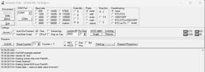

      In adddition i just try to run flexspi_nor_polling_transfer example from SDK. it shows like below,
Am i need to check any hardware related stuffs ?

Gavin_Jia
Hi @ganes_rames ,
Thanks for your update!

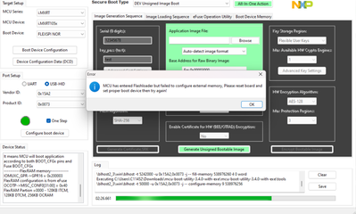

      Thanks for the quick reply, as per your suggestion i try to erase chip using mcu boot utlity tool, i got the below pop-up error, i am completly new to nxp platform.

1,465 次查看
ganes_rames
note : I have changed boot pins to serial downloader mode : off, off, off, on .
