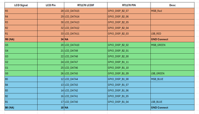

Hello NXP team,
Currently on our board, the image has been output to LCD, but the color seems not correct! We have tried changing the "line output order" such as RGB, RBG, GBR..., but no correct color is displayed
Before continuing to test the software, I want to confirm whether our hardware connection is correct as follows? especially the MSB, LSB order. (although I have referred to the connection of RT1160 EVK)
I appreciate your help
Haryanl

haryanl
Hi Sam_Gao
First I wanted to confirm if there is a problem with my hardware connection!
I found this Post, I used an eLCDIF instead of LCDIFv2, and the colors were displayed correctly
https://community.nxp.com/t5/i-MX-RT-Crossover-MCUs/IMXRT1176-LCDIFv2-with-RGB565-Parallel-LCD-Outpu...
The important point is that "the data bus width of LCDIFv2 is indeed fixed to 24-bit RGB888."
And if I use LCD16 bit RGB565 with LCDIFv2, what is the mapping on LCD_DATA[23:0] pins?
LCD Data line       Color       Bit
LCD_DATA23:19     Red         R4–R0
LCD_DATA18:13      Green     G5–G0
LCD_DATA12:8        Blue        B4–B0
LCD_DATA7:0        Do not use (pad)
Is there any documentation describing Mapping for LCDIFv2?

Sam_Gao
--> Please see the RM, Chapter 48 LCDIF Interface v2 (LCDIF v2), please check if it will meet your requirment.
