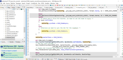

antoniohsu888
Hi, Kerry:
I meet a very strange thing.
Now I try to set all tx/rx to SAI3, when I play audio output, it works.
I can measure data signal output from sai3 tx data pin.
So, could EDMA(DMA0) set for sai1-rx and sai3-tx at the same time ?
The defines are:
/* SAI instance and clock */
#define DEMO_CODEC_WM8960
#define DEMO_SAI SAI3
#define DEMO_SAI_CHANNEL (0)
#define DEMO_SAI_BITWIDTH (kSAI_WordWidth16bits)
#define DEMO_SAI_IRQ SAI3_RX_IRQn
#define SAI_UserIRQHandler SAI1_IRQHandler
#define DEMO_CHANNEL_NUM 2
#define DEMO_CODEC_CHANNEL kCODEC_PlayChannelHeadphoneLeft | kCODEC_PlayChannelHeadphoneRight
//Speaker TX SAI3
#define DEMO_SAI3 SAI3
#define DEMO_SAI3_CHANNEL (0)
#define DEMO_SAI3_IRQ SAI3_TX_IRQn
#define SAI3_UserIRQHandler SAI3_TX_IRQHandler
/* IRQ */
#define DEMO_SAI_TX_IRQ SAI3_TX_IRQn
#define DEMO_SAI_RX_IRQ SAI3_RX_IRQn
#define DEMO_SAI3_TX_IRQ SAI3_TX_IRQn
/* DMA */
#define DEMO_DMA DMA0
#define DEMO_DMAMUX DMAMUX
#define DEMO_TX_CHANNEL (0U) //(0U)
#define DEMO_RX_CHANNEL (1U)
#define DEMO_SAI_TX_SOURCE kDmaRequestMuxSai3Tx //kDmaRequestMuxSai1Tx
#define DEMO_SAI_RX_SOURCE kDmaRequestMuxSai3Rx
3,738 Views

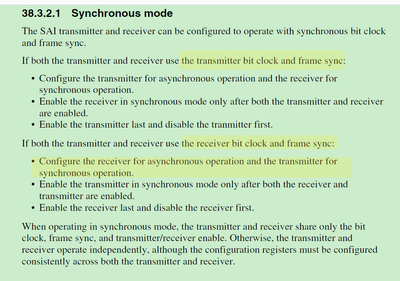

kerryzhou
Hi @antoniohsu888
  Glad to hear you find the new inclue, from your description, it should related to the SYNC for the RX and TX:
You may set the RX: ASYNC, TX: SYNC
Then, even your TX also use the RX BCLK and SYNC.
So, you can debug your code to check it, make sure you set:
saiConfig.syncMode = kSAI_ModeAsync;
Then, even no RX, TX should also work.
Kerry
