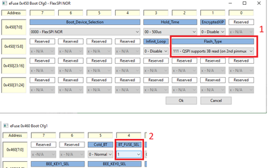

Hi all,
I am working on custom board using MIMXRT1052CVL5B, and  flash W25Q256JV. This board connect W25Q256JV according to image bellow:
My question: "How to boot from W25Q256JV".
Thanks for your help.

jeremyzhou
1) How to boot from W25Q256JV?
-- The hardware connection seems right, you can use the tool to MCUBootUtility tool program an application image to above QSPI, then set the corresponding boot pin or eFuse bit to boot from the flash.
TIC

namht
Thanks for your reply,
This problem is solved.
i have configured "Flash_Type" and "BT_FUSE_SEL":
