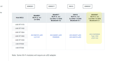

My company is evaluating murata's 1ZM wifi chip (which is based on NXP 88W8987 combo chipset). Using the NXP SDK examples we perform various tests including the iperf test. We were able to set up the 1ZM as an access point but we want to bring it up as an 802.11ac to test at 5Ghz (our antenna is supposed to support that). How can we test this? Which sdk example would be best to use to test 802.11ac?

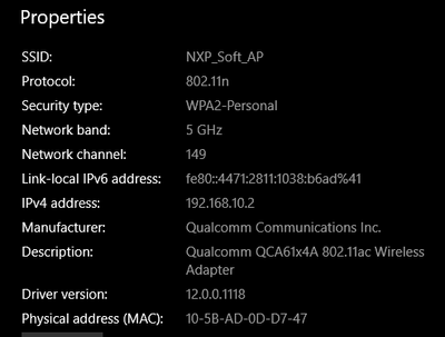

I switched to the evkmimxrt1064_wifi_iperf sdk example. When I set the soft ap with this example it is able to support a network band of 5G. However, the protocol is not 802.11ac. Is there a way to acheive this protocol?
5,839 Views
kerryzhou
Hi @bshannon ,
   Thanks for your effort.
   Please tell me how do you readout the properties?
   From the description, it mentions 802.11ac, is it the other wifi adpator to get the 8987 wifi properties?

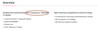

  I checked your module information:
https://www.murata.com/products/connectivitymodule/wi-fi-bluetooth/overview/lineup/type1zm
 It list:
I check the code, it contains 11ac driver, then I think maybe need to check the details, whether the code calls that driver:
Kerry

kerryzhou
Hi @bshannon ,
   Thanks for your patience!
  After internal checking, I get the information that:
8987 Feature List for i.MXRT do not mention 11ac in Soft AP. 11ac is mentioned in STA only.
So, to the Soft AP, you can't use the 11ac, you need to use the 11ac in STA.
Wish it helps you!
Kerry
