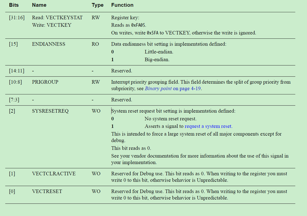

You can find, it will control the ARM CORE Application Interrupt and Reset Control Register
NVIC_SystemReset will reset the system.
About your used reset, you also can check the detail API code, which detail code it is controlling.

  NVIC_SystemReset is the system reset, please check the detail API code:
__NO_RETURN __STATIC_INLINE void __NVIC_SystemReset(void)
__DSB(); /* Ensure all outstanding memory accesses included
buffered write are completed before reset */
SCB->AIRCR = (uint32_t)((0x5FAUL << SCB_AIRCR_VECTKEY_Pos) |
(SCB->AIRCR & SCB_AIRCR_PRIGROUP_Msk) |
SCB_AIRCR_SYSRESETREQ_Msk ); /* Keep priority group unchanged */
__DSB(); /* Ensure completion of memory access */
for(;;) /* wait until reset */
__NOP();
