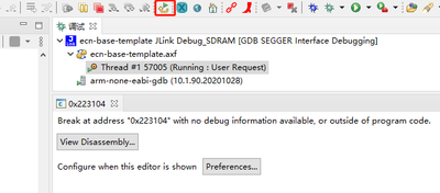

I am working on the Imxrt1176 eval board. We recently ported our MQX C++ Project to FREERTOS . Here, I wanted to do debug from SDRAM, I am using MCU expresso IDE. I prepared the debug script to initialize the SDRAM. I am using the Open SDA port for debugging. I can see the breakpoint hitting main after a few minutes where the launching of debugging session halts at 97%  then hits to the main. But after hitting to main I cannot do step debugging(step in). And also there are no class objects are created.
Kindly let me know if there are any other settings to be done to make successful debugging from SDRAM with openSDA and Jlink.
Kindly review the script files attached for Jlink and opendsda.
Kindly address it early.

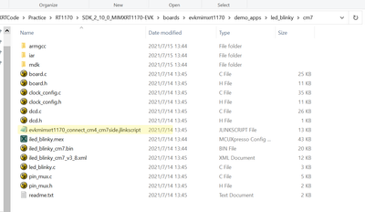

kerryzhou
Hi @venkataddagatla ,
   Do you have tested the SDK code, use the JLINK to debug in the SDRAM, whether that is OK or not?
   SDK code already contains: evkmimxrt1170_connect_cm4_cm7side.jlinkscript
  In the JLINKscript, it configure the SDRAM at first, to the debug mode in SDRAM, it also need the script to initialize the SDRAM at first, please try it on your side.
  I use the SDK code and test it with JLINK, it works OK.
  So, you also can follow me to test the SDK led_blinky code with the JLINK debugger at first, then after it works, you can use your mqx porting code.
The JLINK script can be found from this link:
SDK_2_10_0_MIMXRT1170-EVK\boards\evkmimxrt1170\demo_apps\led_blinky\cm7\evkmimxrt1170_connect_cm4_cm7side.jlinkscript
Please try it on your side.
If you still have questions about it, please kindly let me know.
Kerry

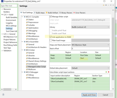

venkataddagatla
yes, I will check I get you back for the Jlink script in the SDK.
Before that, my query is how to debug from SDRAM, here from the pics that you have shared that has BOARD_FLASH as a default memory. It means it is debugging from Flash and not from SDRAM.
11,337 Views
kerryzhou
   my laster reply picture 3, select link application to RAM, that already set the code to the secondary one sdram. This is the special good function in the MCUXPresso IDE.
  You also can check the build image, the code is in the SDRAM, you even see my debug result, the code is in the sdram.

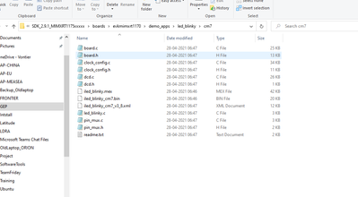

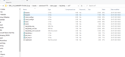

venkataddagatla
I have checked in the SDK I couldn't find the Jlink script in the cm7 folder. Kindly can you share the script file here?
11,330 Views
kerryzhou
   Your SDK is old, please use the newest sdk SDK2.10.0:
https://mcuxpresso.nxp.com/
Kerry
11,186 Views
nxbg
Hi Kerry,
I download evkmimxrt1170_connect_cm4_cm7side.jlinkscript from your previous attachment inside this topic, but actually the newest 2.10.1 SDK does not have this file actually(I extract the SDK file and search this file but got nothing).
