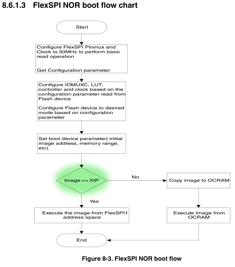

I can find this figure in the reference manual:
and I wonder how the ROM bootloader manages to decide in which of the two branches of the highlighted if block should go.
Which IVT and boot data structure fields does it check? What values do they have to take to go to one or the other branch?
best regards
Max

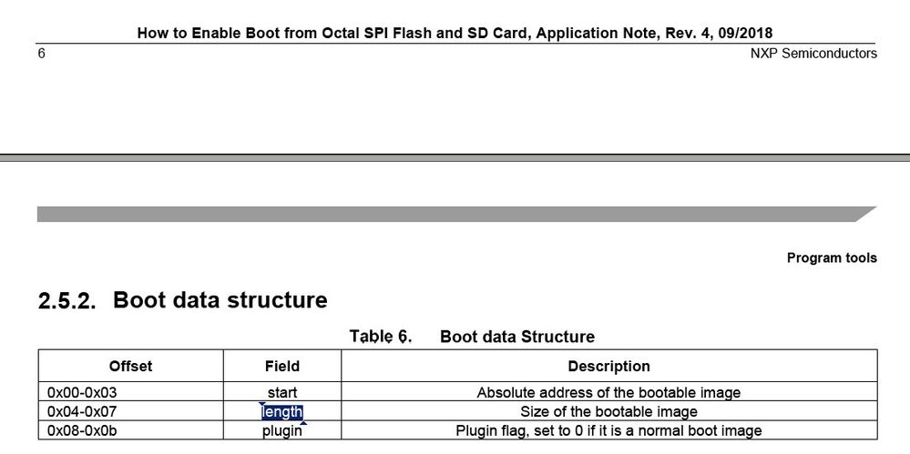

you are right, it checks boot data structure fields as described in Figure1 Bootable image layout
AN12107 How to Enable Boot from Octal SPI Flash and SD Card
and if destination memory is the same as boot memory, it considers it as xip.
https://www.nxp.com/docs/en/application-note/AN12107.pdf

so, the ROM bootloader needs to know the addresses and size of the boot memory and the destination memory.
I guess the ROM bootloader can deduce the boot memory address based on the boot device selected by the fuses, right? (I don't know about its size).
I wonder which fields of IVT and/or boot data structure are used by the ROM bootloader to infer address and size of the destination memory. Entry field of IVT? Start field of boot data structure?
What happens if Entry does not reside within the memory defined by boot data? What if the boot memory is also different?
best regards
Max

igorpadykov
size does not matter, address fields are described in Figure1 Bootable image layout
igor

mastupristi
Senior Contributor I
so, to determine if XIP or not XIP, the ROM bootloader uses the start field of the boot data structure and compares it with the boot memory address space, right?
The flash is at the address 0x60000000, in my case it's big 2MB, so it ends at the address 0x601fffff
In the case of XIP the start field has to contain the value 0x60000000 (base address of the flash)?
If start contained a value different from 0x60000000 but still inside the flash, such as 0x60003000, would it be XIP or not XIP?
Does the IVT Entry field not affect the ROM bootloader in the choice between XIP and non-XIP?
best regards
Max
4,558 Views
igorpadykov
ROM bootloader knows that it boots from FlexSPI and then see that destination
memory addresses also in that range (Table 2-1. System memory map i.MXRT Reference Manual),
so it considers it as xip. If it see that destination memory addresses are in SEMC external
memories (SDRAM) then it is not xip.
igor
