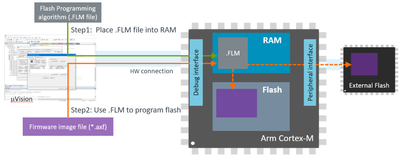

I've just found out on the keil website the following link
Programming External Flash with STM32 Devices (keil.com)
It contains the whole procedure of creating the flash loader for STM32, but it does not really matter for the topic in question.
The essential part that basically explains the procedure was shown on the image below:
For more details, see the link above.
