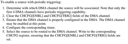

Hank888
Could you please help me see what's wrong
The PIT cannot trigger the DMA module to perform the send/receive action of LPSPI

Hello @Hank888,
First of all, we apologize for taking too much time to answer you.
Looking at your code and i.MX RT1050 Processor Reference Manual. Chapter 5. Direct Memory Access Multiplexer (DMAMUX). Section 5.5.1. Enabling and configuring sources, we noticed that to enable a source with periodic triggering you should follow the next steps:
[i.MX RT1050 RM. Section 5.5.1. Enabling and configuring sources]
With the help of pit and lpspi_edma_b2b_transfer_master examples, using your code, and the mentioned steps above, you could try writing something similar to the following to configure the PIT triggering the DMA + LPSPI:
/* DMA MUX init*/
DMAMUX_Init(EXAMPLE_LPSPI_MASTER_DMA_MUX_BASE);
// Enable periodic triggering
DMAMUX_EnablePeriodTrigger(EXAMPLE_LPSPI_MASTER_DMA_MUX_BASE, EXAMPLE_LPSPI_MASTER_DMA_RX_CHANNEL);
DMAMUX_EnableChannel(EXAMPLE_LPSPI_MASTER_DMA_MUX_BASE, EXAMPLE_LPSPI_MASTER_DMA_RX_CHANNEL);
DMAMUX_EnablePeriodTrigger(EXAMPLE_LPSPI_MASTER_DMA_MUX_BASE, EXAMPLE_LPSPI_MASTER_DMA_TX_CHANNEL);
DMAMUX_EnableChannel(EXAMPLE_LPSPI_MASTER_DMA_MUX_BASE, EXAMPLE_LPSPI_MASTER_DMA_TX_CHANNEL);
