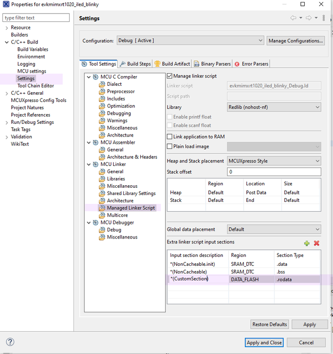

What do you have to do if you want to split off part of the QSPI FLASH to be for read only data storage and how do you declare and use that constant variable in your source code?
I am using MCUxpresso and a RT1021 processor.  What do you have to set in the IDE to do this?

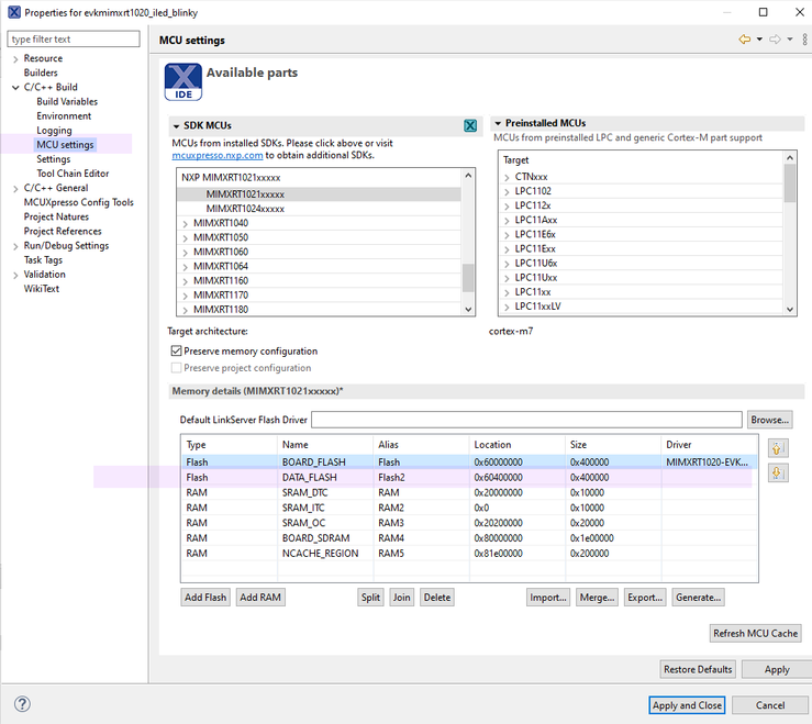

1 Split the flash. You can modify the size and adress to your desired preference, I only made a simple spit.
2 Provide a meaningfull name to the flash area, I used DATA_FLASH.
3 Create an extra linker section. I created CustomSection in the DATA_FLASH area I created earlier. The type is rodata, as I will place a constant array there.

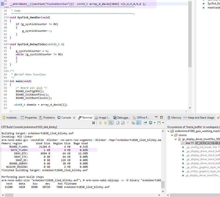

4 Use a macro to place this variable.
__attribute__((section("CustomSection")))  uint8_t array_4_davie[1024] ={1,2,3,4,5,6 };
5 Re-compile and verify that the macro does works.
As you can see in the debug output the array_4_davie is placed in Custom section, which belongs to DATA_FLASH section.

799 Views
DaveG1
Thank you!  That did the trick.
