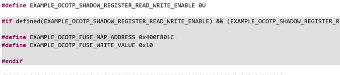

VolcanicCheese
Thank you for taking the time and answering my question.
Context of the Question
I am currently using a Jlink EDU connector.
The board is in serial downloader mode.
I tried flashing and debugging the board with the SDK project.
I set up the fuse map address and write the value as shown below for the example project to burn the eFuse to set up the boot mode to internal boot mode.
I figured out the fuse map address and fuse write value based on this page on the reference manual.
Flashing the program do not do anything because it seems the project works on runtime.
Question: Where do I setup the fuse map address and write value to burn the fuse with serial downloader mode using a Jlink Connector with the OCOTP example SDK project?

VolcanicCheese
Thank you for taking the time to read my question and answering them!
Question: You need to download the code to the internal RAM in the serial download mode, can you debug it step by step?
Answer: No, I was not able to debug it step by step and I was not sure how to ensure that the code gets download to the internal RAM. When I run the code,  It gets stuck at the boot ROM as mentioned on the post that I linked.
Question: Your mentioned your fuse didn't work previously, please tell me which detail area you modified? And the readout value, then I will help you to check the position.
Answer: Sorry if this does not make any sense, what I am saying. I am new to this and trying to figure this out. I am using the Boot Mode Register Address and trying to write a bit to BT_FUSE_SEL.
I was not sure where in the example SDK project I am supposed to write the fuse map address and write value. Looking at the example SDK project. It seems like I need to write the values here as shown in the screenshot below:
But is this not for the shadow register? I thought the shadow register works by allowing you to see what happens if you do burn the eFuse without burning the eFuse.
Question: Now, what's the IDE you are using?
Answer: MCUXPRESSO IDE

kerryzhou
Hi @VolcanicCheese
1. Run code in RAM in the MCUXPresso IDE
Answer: Please use the following configuration:
Select the Link application to RAM, then your code will run in debug mode, even you work in serial download mode, I have tested it, and confirm serial download mode, the RAM debug is OK.
2. I was not sure where in the example SDK project I am supposed to write the fuse map address and write value
Answer: You are right, EXAMPLE_OCOTP_SHADOW_REGISTER_READ_WRITE_ENABLE is used to control the write code, as you know, fuse is one time operation, it just can be modify from 0 to 1, and can't write back. So, to the SDK code, it is very careful, and don't want the customer write the fuse directly, so it just give a fuse read version.
When customer need to write the fuse, customer can set
#define EXAMPLE_OCOTP_SHADOW_REGISTER_READ_WRITE_ENABLE 1U.
You also need to double check the fuse address, which is the correct address area.
To be honesty, to the new user, normally, I don't recommend customer operate the fuse, but your customer board situation is special, you didn't leave the GPIO for the BOOT_CFG.
Wish it helps you!
