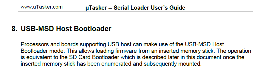

ethanchen
Hi Mark,
It is Host on RT1021.
From uTasker user's guide look up have HOST BootLoader
But how can to get this source code? I don't found it, or need to contact with uTasker?
Thank you.
Ethan Chen

mjbcswitzerland
Specialist V
Ethan
See
https://www.utasker.com/iMX/RT1020.html
and
https://www.utasker.com/Licensing/License.html
Note that most of the loader modes are now available for most i.MX RT parts but the USB host mode is presently in development and so will not be ready for another few days to a couple of weeks.
