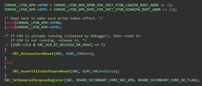

We’ve resolved the issue.
The problem was that BOARD_BootClockRUN() was called at the top of the main() in the M4.
So when the M4 was restarted, it would overwrite the clock configuration that was setup by the M7’s BOARD_BootClockRUN() .
As a result, the M7 couldn’t use any of its peripherals properly after an M4 reset, as the clocks were incorrect.
The solution required the following steps:
  1. Remove the clock configuration code from each individual source file (in both projects)
  2. Configure the required clocks in the M7’s clock ConfigTool
  3. Remove the BOARD_BootClockRUN() call in the M4’s main()
  4. Add the clock configuration required for the M4 core to the M4's main. This code was identified by trial and error from BOARD_BootClockRUN() code surrounded by #ifdef __M_CORE_ == 4.
    The required code is shown below:
