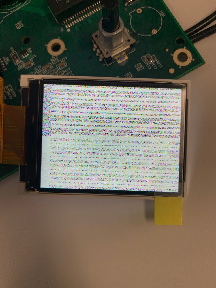

HI there,
I'm trying to add an LCD (ST7789H2) to my project and I configured my SEMC dbi config as follows:
dbi_config.csxPinMux = kSEMC_MUXA8;
dbi_config.address = DBI_START;
dbi_config.memsize_kbytes = 32U*1024;
dbi_config.columnAddrBitNum = kSEMC_Dbi_Colum_9bit;
dbi_config.portSize = kSEMC_PortSize16Bit;
dbi_config.burstLen = kSEMC_Dbi_BurstLen16;
dbi_config.tCsxHold_Ns = 200;
dbi_config.tCsxInterval_Ns = 200;
dbi_config.tCsxSetup_Ns = 200;
dbi_config.tRdxHigh_Ns = 200;
dbi_config.tRdxLow_Ns = 200;
dbi_config.tWexLow_Ns = 200;
I use the base address as A0000000 but when I try to write an 8-bit value as below
 #define DBI_START  0xA0000000U//(0xA0000000U)
uint16_t *my_dbi = (uint16_t *)DBI_START; // DBI Base address. */
my_dbi[0x10000] = Reg;
I always hit a hard fault (Imprecise bus data error). Am I using the wrong address? Any help will be appreciated.

Hi Jeremy,
I was able to resolve the hard fault issue but I have a different issue with the LCD now.
With the DBI_START set to 0xA0000000, I'm able to write commands to the LCD, say I'm able to write an invert display command and I can see it taking effect on the physical display. However, I'm unable to write any data.
I use my_dbi[0x10000] for writing commands and this works. But, when I use my_dbi[0x1000] to write data, say to write the color blue to the entire screen, that doesn't work. All I see is a random pattern on the screen. Please see the attached picture.LCD_issue.JPG
I also tried a different address for the DBI_START as 0xB0000000. I'm not sure what is the problem here that's causing data not to be written.

Hi THIVYA ASHOK KUMAR ,
Thanks for your reply.
I was wondering if you can share the sample code, as I don't have a clear idea of the below description.
