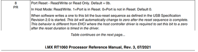

PORTSC1 |= (USBHS_PORTSC1_PR);
This is not an issue with the device being reset but is this quite large deviation from the standard 10ms time intentional?

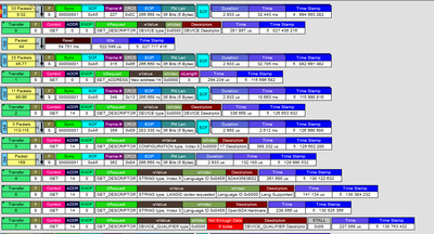

I did a test with my PC to connect FRDM-KL27Z OpenSDA (FS device) and get below result:
When I use RT1060EVK board running <host_msd_fatfs_bm> demo with FRDM-KL27Z OpenSDA FS device with below enumeration info:
Could you let me know which RT SDK USB host example you are using?

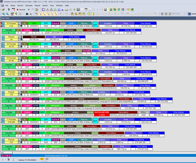

Yes, I did the same test again with my PC connects with FS device got the same result:
Reset: 54ms.
Below is the transfer info:
