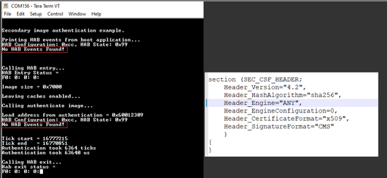

Hi @BiHDeveloper
Thank you for reaching out!
Before diving further, could you manually modify the BD files to have the Header_Engine as any? Then let me know your results
Edit: after you update the bd file, as shown above, build the image again, beware of the SPT auto generating BD files when build image button. To avoid this you can run manually the build_image script from the project workspace. Then write the new image into the processor.
Please let me know if you see any changes.
Diego

BiHDeveloper
Hi, thank you for the suggestion.
I already manually modified the BD files and set the Header_Engine field to any, but the result is still the same. I'm still receiving a HAB warning during authentication.

diego_charles
Hi @BiHDeveloper
Thank you for taking a time to look on your side!
On the past , I have removed the  HAB API warnings by changing  the engine from DCP to ANY on all of my BD files, on the past on the RT1060. So I need to investigate further with you.
