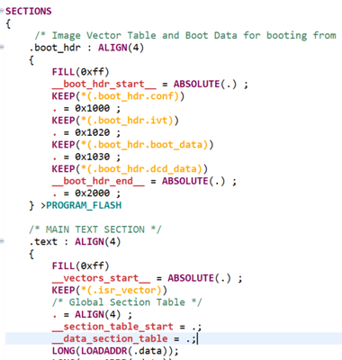

1. You have to check flash-loader project linker file manually to find start address

Hi @gsbalajikrishnan ,
1. Please see the .ld file if you use MCUXpresso IDE.
The first part (above 0x2000) is head. The second part is application image. __vector_start_ is interrupt vector table. Application start address(ResetISR) is at 0x2004. Please note that different configure may have different head. Please read the System Boot chapter in reference manual.
2. Since the application image will be put into flash finally, IVT and FCB is needed. The first 0x2000 bytes should be reserved. Please let your code start from 0x20202000 at least.
