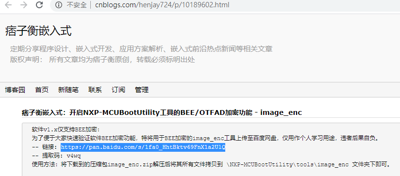

Hi Ken Su ,
  Can you use the Baidu Cloud?
   If yes, you can download it from the following link:
痞子衡嵌入式:开启NXP-MCUBootUtility工具的BEE/OTFAD加密功能 - image_enc - 痞子衡 - 博客园
  Please download the second one, v2.x.
  Then you can add this image_enc in the MCUBootUtility tool, and do the BEE encryption operation.
  More details, you can refer to this link:
https://community.nxp.com/thread/519126#comment-1273495
Kerry

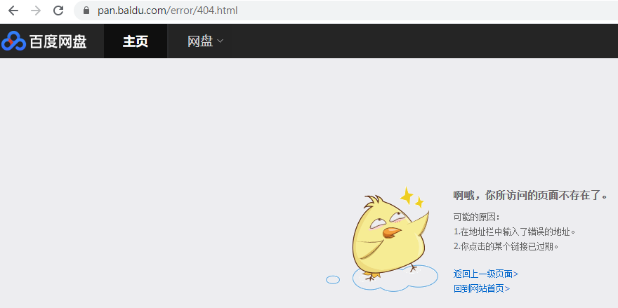

Hi Kerry
Very Thanks for your reply.
I try to download from this link, but no data.
Could you help me double confirm?
Actually, I am very curious about two things.
1. Why this tool is download from Baidu Cloud, not NXP official link?
2. I cannot find any NXP official released application node about how to use image_enc.exe.
I know there are some information in community. But why NXP cannot release a simple SOP/Application node or manual for image_enc.exe officially?
And there are manual about elftosb, blhost, sdphost. However, no manual for image_enc.exe.
It's look like NXP don't expect the developer use image_enc.exe?
Ken

felix1
Hi Ken Su,
If you want to download baidu from Taiwan, you need to through VPN connection.
1,415 Views
