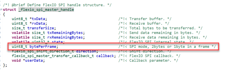

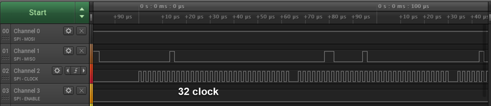

How can I change the bytes per frame in the flexio spi example for IMX RT1060? I need to send 96 byes in a single transfer. Is that even possible?

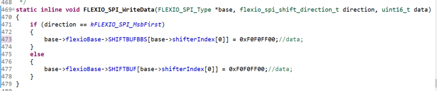

Could you debug the code?
If yes, please set a breakpoint at FLEXIO_SPI_WriteData() function entry point in  FLEXIO_SPI_MasterTransferNonBlocking() function. Then you could see if the FLEXIO_SPI_WriteData() will be called twice or more times.
I did the quick test, I just using the fixed data in FLEXIO_SPI_WriteData() function:
You could set the TRANSFER_SIZE be 8 for a quick check.

Hui_Ma
Hi Andre,
Please check my test code attached.
The major change at
<fsl_flexio_spi.c> FLEXIO_SPI_MasterTransferNonBlocking() function ;
FLEXIO_SPI_WriteData() function in <fsl_flexio_spi.h> file;
Wish it works.

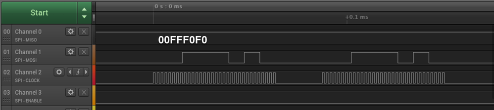

I do the test with one frame with 32bit with MSB (total transfer size is 8 bytes), and directly write 32bit value to Shiftbuffer with FLEXIO_SPI_WriteData() function in <fsl_flexio_spi.h> file :

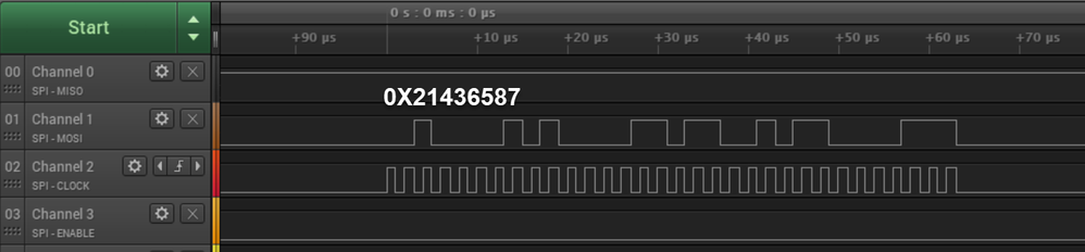

I could get below SPI transfer signal:
If I send data 0x87654321, I would get below transfer signal:

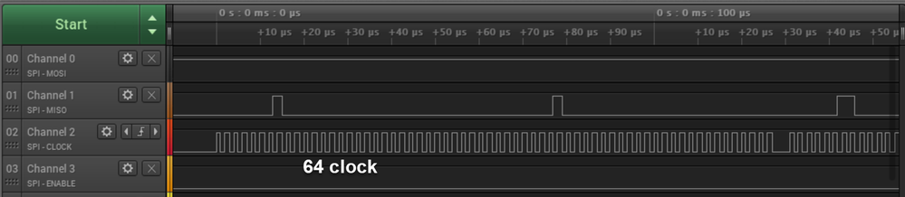

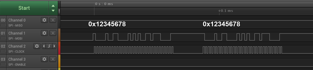

I did another test with SPI frame size to 64bit with MSB:
I don't change the code to write 64bit data at the same time, which need software support to write the Shift buffer register (32bit) twice with different value. During the test, it will write the Shiftbuffer twice with same value 0x87654321. Then I could get below transfer signal with 64bit

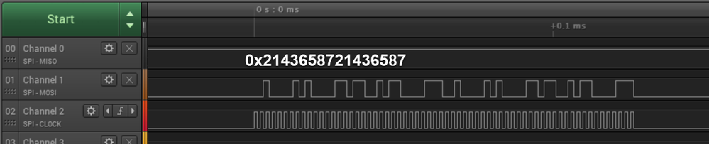

I did the test for 32bit LSB to send 8bytes with value 0x8765432187654321, get below transfer signal:
I did the test for 64bit LSB to send 8bytes with value 0x8765432187654321, get below transfer signal:

Hui_Ma
Hi Andre,
I made below modification with <fsl_flexio_spi.c> FLEXIO_SPI_MasterTransferNonBlocking() function and related _flexio_spi_transfer_flags in <fsl_flexio_spi.h>:

During the master transfer using related setting:
/*Start master transfer*/
masterXfer.txData = masterTxData;
masterXfer.rxData = masterRxData;
masterXfer.dataSize = TRANSFER_SIZE;
masterXfer.flags = kFLEXIO_SPI_32bitMsb;
Then I could get below SPI communication signals:

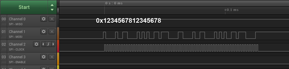

If I use kFLEXIO_SPI_64bitMsb, then I could get below SPI communication signals:
Wish it helps.

I was able to generate a flexio Spi clock of 1khz by changing the source clock of the flexio peripheral. Now I generated 48 clock cycles that I need for my single transfer of 6 bytes. The issue I’m having now is I can’t send all of my 6 bytes in a single data frame. What settings do I need to change to be able to send more than 2 bytes. In the driver I only see options for sending 16 bits of data. Do I need to modify the driver, if so please give me some guidelines.

There do need to modify the SDK provided driver.
While, I don't find there with combined shifter description for shifter data output with RT1060 FlexIO module.
 The SHIFTBUF size is 32bit, which doesn't support up to 6 bytes transfer in a single data frame.

I checked with RT product team, the RT1060 FlexIO shifter number is 4, each shifter supports 4 bytes.
If all 4 shifters using for SPI TX, which could support up to 16 bytes per frame.
If it still need supporting SPI TX&RX, which could support up to 8 bytes per frame.
There is impossible to set 96 bytes in a single frame.

Hui_Ma
The FlexIO SPI master handle structure definition the SPI mode of how many bytes in a Frame.
There only with two types: one byte or two bytes in a frame.
Customer could refer SDK provided [evkmimxrt1060_flexio_spi_int_lpspi_transfer_master] demo to set the TRANSFER_SIZE value to transfer 96bytes with call FlexIO spi transfer API function once.
