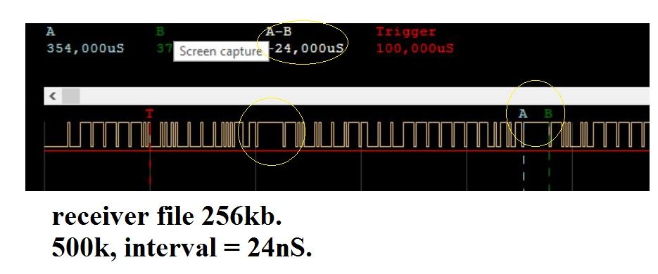

my test with   RT1020-EVK
receiver file via CAN 500kbps.
Problems:
file 256k.....receiver 10k, 36, max 46k, and values the bytes in frame.
The interval between frames is 24,000 uS, and I use interrupt to save frames, then I can't time to reset the receiver and end up losing frames.
see:

Solved problems!
FRAME: 01 E8 08 DC B2 AE AA AE AA AE AA   <----error = memory sram onboard
not problems with CAN 500k, problems is memory problems save data.
saved data in Ram internal, no more problems.

problemas "interval" solved with CAN polling,
receiver file lenth ok.
now other problems.
bytes diferent in frames.
example:
FRAME: 01 E8 08 DC B2 AA AA AA AA AA AA

Solved problems!
