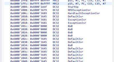

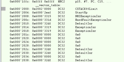

Adding more information on this issue.
I am attaching snaps of interrupt table which starts from 0x60002000 (define symbol m_interrupts_start = 0x60002000;) for IAR and eclipse(using cmake) with IAR toolchain.
We can see clearly in case of Eclipse CSTACK is not available at 0x60002000 but in IAR it is in correct place so it is working.
Eclipse interrupt table :
IAR interrupt table :
  Eclipse CSTACK location :
