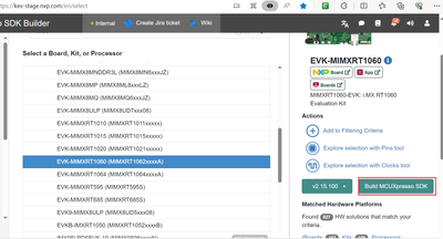

Select Board | MCUXpresso SDK Builder (nxp.com)
Please download the MIMXRT1062 SDK, and unzip it.
Flexspi polling_transfer example is in the SDK_2_15_0_EVK-MIMXRT1060\boards\evkmimxrt1060\driver_examples\flexspi\nor.
And Flexspi driver is in SDK_2_15_0_EVK-MIMXRT1060\devices\MIMXRT1062\drivers.

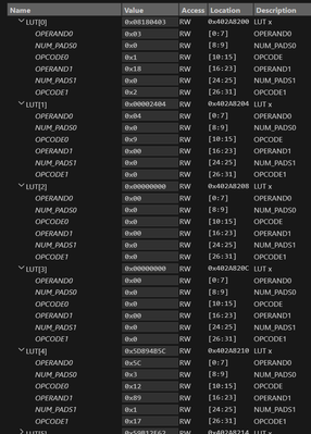

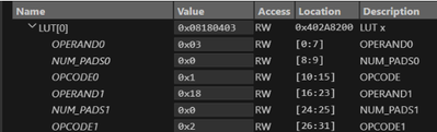

I also noticed when viewing the LUT values with the debugger (using the svd)  for this chip that the LUT values are updated but do not match the values that I downloaded.

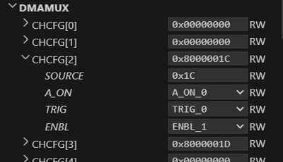

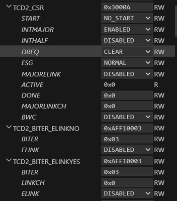

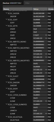

I use DMA channel 2 for the rx operation.  I see in EDMA (DMA0 in peripherals) that ERQ is enabled for channel 2.

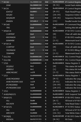

anthony_asterisk_0-1713899795196.pnganthony_asterisk_1-1713899828990.pnganthony_asterisk_2-1713899873520.pnganthony_asterisk_3-1713900075616.png
The LUT shows unexpected values that do not match the data sent:

There is no opcode in this Lut, so it must be an error. And you say that "RX DMA however it never gets the interrupt with complete status."
You can first confirm whether there is data in RXFIFO. If there is no data in RXFIFO, it will not trigger DMA interrupt.
And i suggest that you can test polling_transfer. if the polling_transfer can work, you can test the DMA transfer.

Also please explain why the LUT as viewed in the debugger does not match the LUT I programmed.

2.I don't know what your Lut is, but the Lut you sent me last time was definitely incorrect.
const uint32_t customLUT[] = {
[LUT_SEQUENCE_SIZE_WORDS * LUT_SEQ_IDX_WRITE] =
FLEXSPI_LUT_SEQ(kFLEXSPI_Command_WRITE_SDR, kFLEXSPI_1PAD, 0, kFLEXSPI_Command_STOP, kFLEXSPI_1PAD, 0),
[LUT_SEQUENCE_SIZE_WORDS * LUT_SEQ_IDX_READ] =
FLEXSPI_LUT_SEQ(kFLEXSPI_Command_READ_SDR, kFLEXSPI_1PAD, 0, kFLEXSPI_Command_STOP, kFLEXSPI_1PAD, 0),
And this Lut doesn't match the register either.
3.You can refer to my lut, and the register.

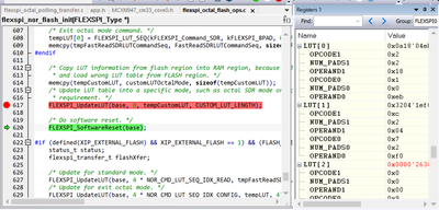

The picture I sent just wants to illustrate what you mentioned above.
"explain why the LUT as viewed in the debugger does not match the LUT I programmed."
And my LUT in picture can match the register in picture. Instead of configuring your Lut to be the same as mine
