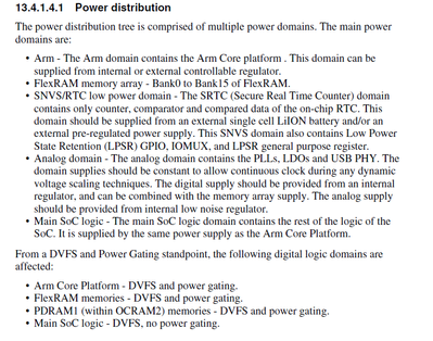

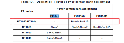

We are looking into sram data corruption after MCU wakes up from suspend more. Does i.MX-RT1040 has power domain `PDRET`?
I see i.MX RT1040 not listed in AN12077 "Using the i.MX RT FlexRAM" https://www.nxp.com/docs/en/application-note/AN12077.pdf

  Yes, I also found that  i.MX RT1040 not listed in AN12077.
I consulted with the relevant experts, response is that the RT1040 can refer to the RT1060.
I also check IMXRT1040RM, no PDRET domain definition in chapter 13.4.1.4.1.

In AN12077,there are some description about Power domain bank assignment.
