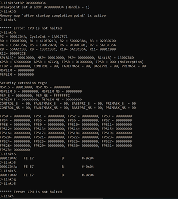

surabhi_sk30
I am able to see that PC pointer value and the break point value are same through the binary generated by IDE.
But the binary file which is generated by our framework, the values for PC and break point which I have given are different, the main function is not getting hit.
The PC value contains 0001C04A when I provide breakpoint at address on main(0x00008034)
can you please suggest how to debug on that.
Surabhi.

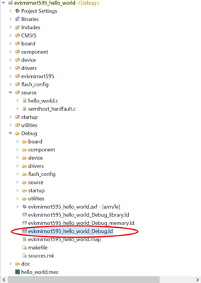

Gavin_Jia
Hi @surabhi_sk30 ,
Yes, this linker file located at this path showing in the pic below. We need to build the code first, and it will appear in this location after the project is built.
Gavin

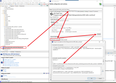

3,896件の閲覧回数
Gavin_Jia
Hi @surabhi_sk30 ,
Thanks for contacting NXP tech support!
1. Regarding how to use JLink Commander, if you are not familiar with it, we recommend you to operate it once with MCUXpressoIDE and then read the script file it generates.
2. About how to see if you're in main:
You can look at the Image information through MCUXpressoIDE to get the run address of the main function, and then, in JLink Commander, put a breakpoint here.

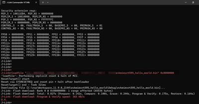

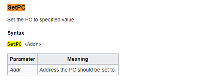

Gavin_Jia
Hi @surabhi_sk30 ,
Yes, I understand your point. The reason for pointing out how the IDE operates is because it is possible to visualize here every command used by JLink Commander at the time of flash image. We can use them through JLink Commander. The picture I attached is how it works with JLink Commander.
For a detailed list of exactly how to set up commands such as the PC pointer, Segger provides this: https://wiki.segger.com/J-Link_Commander
