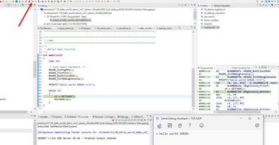

All you need to do is click Debug in the IDE to get this image running in SDRAM. Of course if you are interested in how to perform this operation using the command line, you can also view it using GUITool, which has an internal "preview command" option.
By disassembling the address in the screenshot below, you can see that the code is already running at the SDRAM address 0x8000_xxxx:
