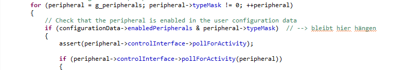

- also I failed to debug the 1060_flashloader example in the IDE (it stops in get_active_peripheral())

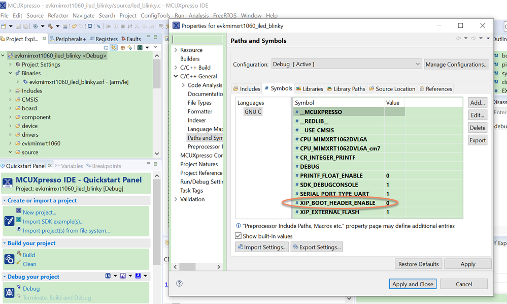

kerryzhou
Hi Per Canal ,
   Do you try to use the flash loader and the MFGtool on your side directly?
   Whether it works or not?
  I have a question when you generate the app file, do you disable the XIP header? XIP_BOOT_HEADER_ENABLE=0
  More details, please check the application note:
  https://www.nxp.com/docs/en/application-note/AN12107.pdf
  You mean, when using a secure provisioning tool, generate the code is correct, but when you want to write it, it fails, right?

per_canal
Hello Kerry Zhou
Thank you for your reply and sorry for my late reply!
First I tried to compile the evkmimxrt1060_flashloader example in the debug mode. It seems like the program is in a endless loop in "get_active_peripheral".
After that I tried to work with the secure provisioning tool to generate my bootable image and to write it in a first step to my imrxt1060 board.
The connection to my board is ok. SW7 is set to 0001 and I set the XIP_BOOT_HEADER_ENABLE=0. To generate a bootable image is successfull. But write image generates the mentioned error above.
Thank you in advance!

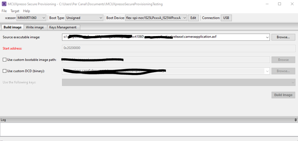

Hi kerryzhou
The led_blinky example worked after i changed the boot device from flex-spi-nor/IS26 to flex-spi-nor/IS25WP.
I have now a different question/problem:
I want to use the MCUXpresso tool to update the firmware on field. So I loaded my .axf file (source executable image) to the tool. The processor, boot-type etc. settings are the same as before. It seems that I have now a problem with the file size.
Start address is red with followed error message: "Image size 1071922320 if greater than target bootable memory size 67108864".
Start address is detected at 0x20200000.
In the explorer the application (source executable image) has a size of 5 MB. How is it possible that its so mutch bigger while trying to load it in the MCUxpresso tool?
Thank you for your help!
Per

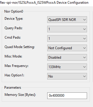

per_canal
Hi kerryzhou
1) I use the Secure Provisioning Tool.
2) No I used the QuadSPI SDR NOR for the example and now also for the application.
3) The source image is bigger according to the tool, but in the IDE in debug mode it works fine
4) I didn't try it yet with the MCUbootUtility, because i thought it would be easier with the secure provisioning tool

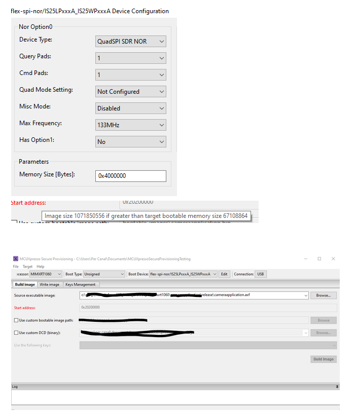

per_canal
Hi kerryzhou
Yes your .s19 and my .s19 example file (imported from SDK examples) work both. But if I try to load my self-writen firmware to the board (with exactly the same steps as yours) the above showed error messages occure.
Find here again my settings and the error messages:
6,075 Views
kerryzhou
Hi Per Canal,
  From your picture, seems it caused by the image size is greater than the target bootable memory size.
  Do you try to minimize your own app, smaller than 67108864, whether it works or not?
If you still have questions about it, please kindly let me know.
Kerry
6,075 Views
per_canal
Hi kerryzhou
It confuses me that the source executable image is while loading it in to the secure provisioning tool bigger than before. Do you have an answer for that? It is litteraly the question I asked you before...
Per   <-----
Also do you know where I can change the vector table or the start address?
Thank you in advance.
