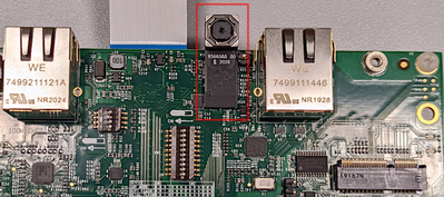

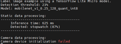

I failed to run "tensorflow_lite_micro_label_image_cm7" example on my RT1170 EVK.
Test environment:
MCUEXPRESSO: V11.6.1
SDK RT1170-EVK: V2.12.1
CAMERA: R5640AA
Then I observed that camera initialization failed via console.
I investigated into source code and found the error caused by:
So I need your help to verfify this example project on your side on the same board - RT1170 EVK with the same camera.
If it desen't fail in your side, please tell me how you make this.
Otherwise, please help modify this example project to make it run smoothly.

Hi @samuelzhang,
Could you tell me from where you bought this camera?

jingpan
Hi @samuelzhang ,
My SDK version is 2.11. It works fine. But I think this is not the version problem. Have you tried other camera demos? Can they work?
There is a readme in the project. Have you read this guide?
