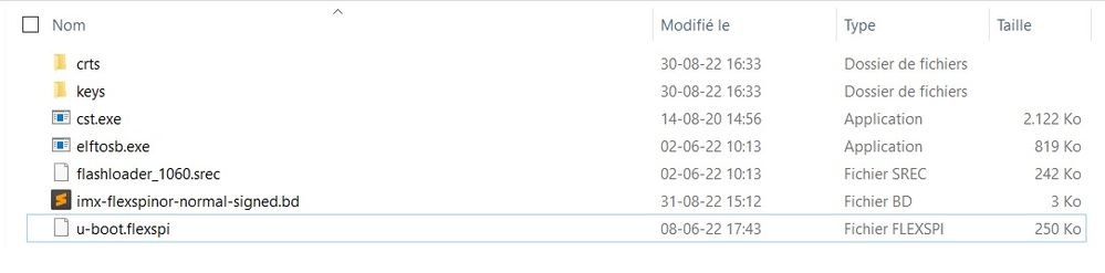

I am trying to activate the HAB on my MIMXRT1060EVKB board but I am failing to generate a signed flashloader.bin file in order to load a signed firmware on the board.
1. I have generated the set of certificates and keys (4 public keys) according to the documentation provided in the CST documentation (and have cross checked it with information given in the "RT1050 HAB Encrypted Image Generation and Analysis" article and also in the "i.MX RT: Secure Boot Episode 1" lab information). I also generated the hash table and signature files according the those documents and everything seems to be fine.
2. Following instructions given in section 4.3 of the i.MX RT 1060 Manufacturing User's Guide (doc IMXMCUMFUUG) (which are pretty similar to the instruction given in the above mentioned documents) I have:
- Generated an .sd file

- Copied all required files to the same folder as the one containing the elftosb.exe utility
3. I run the following command line to try to generate the signed flashloader .bin file. The command line only returns the following line then stops and generates a 0kB evkbmimxrt1060_flashloader_signed.bin file
>elftosb.exe -f imx -V -c imx-flexspinor-normal-signed.bd -o evkbmimxrt1060_flashloader_signed.bin flashloader_1060.srec

Hi @FMA ,
1) Could you help me figure out what I might be doing wrong?
-- In the above .bd file, the start Address and entry Point Address point to the FlexSPI's memory map, however, the flashloader should be executed in the RAM, so they're definitely in conflict.
2) So how can the output file be actually authenticated since the public key should not be secret and could be associated to any firmware ?
-- The elftosb.exe will locate the corresponding private keys under the keys folder according to .bd file, then sign the image file offline.
3) Can you clarify what those two properties relate to and how they actually differ ? Also, what is the actual purpose of the SEC_CSF_AUTHENTICATE_DATA.Authenticate_DataVerifcationIndex property ?
-- Please check the attachment, however, it's unnecessary to spend a lot of time figuring them out, in my opinion, it's okay to have a genal overview of them, as we usually use the GUI tool to generate the bd file automatically instead of creating a bd file manually.

The IVT offset is impacted by the boot device type (see table  9-36) and can be either 0x1000 or 0x400:
- 0x1000 for FlexSPI NOR/SEMC NOR
- 0x400 otherwhise
35,342 Views
FMA
Hello Jeremy,
Thank you for you answer, I think it did solve my problem (at least know I have the elftosb finishing and producing the two expected .bin files).
Just for the sake of information, I applied the following change to the option section of the bd file:

Just for the sake of completing my post, it is now solved:
- The binary firmware generated by our BSP cannot be directly signed by elftosb since I have to add the u-boot DTB into the structure. However, having downloaded the latest version of elftosb utility, as this one generates the intermediate .csf file used by the cst, I could track down the issue.
With a little bit of manual edition of my binaries (I will now have to script it) I could generate a signed firmware that gets my board starting!

Hi @FMA ,
