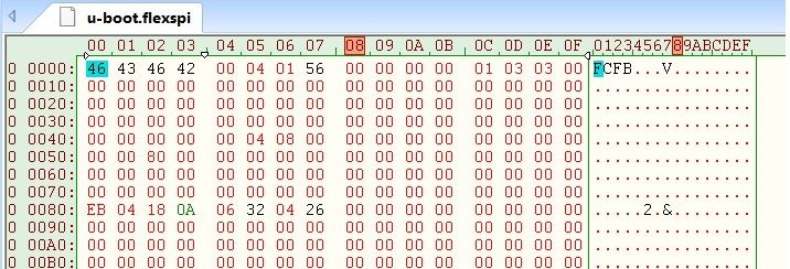

I also loaded a signed firmware to the SPI NOR memory connected on flexSPI interface, but, once I have configured back the switches for internal boot, the board does not seem to boot anymore.
Here is what I have done:
Modified the "options" section of the .bd file I used for the flashloader in order to reflect the change of memory and the information present in the unsigned firmware I used to successfully boot on the board:
options {
    flags = 0x08;

Added the information in the "FlexSPI Configuration Block" at the beginning of my file. These information are located from address 0x0000 of my file
Copied the resulting binary to the FlexSPI NOR memory using the above mentionned lines in the examples of interactions I could have with the board.

Just for the sake of completing my post, it is now solved:
- The binary firmware generated by our BSP cannot be directly signed by elftosb since I have to add the u-boot DTB into the structure. However, having downloaded the latest version of elftosb utility, as this one generates the intermediate .csf file used by the cst, I could track down the issue.
With a little bit of manual edition of my binaries (I will now have to script it) I could generate a signed firmware that gets my board starting!

Hi @FMA ,
1) Could you help me figure out what I might be doing wrong?
-- In the above .bd file, the start Address and entry Point Address point to the FlexSPI's memory map, however, the flashloader should be executed in the RAM, so they're definitely in conflict.
2) So how can the output file be actually authenticated since the public key should not be secret and could be associated to any firmware ?
-- The elftosb.exe will locate the corresponding private keys under the keys folder according to .bd file, then sign the image file offline.
3) Can you clarify what those two properties relate to and how they actually differ ? Also, what is the actual purpose of the SEC_CSF_AUTHENTICATE_DATA.Authenticate_DataVerifcationIndex property ?
-- Please check the attachment, however, it's unnecessary to spend a lot of time figuring them out, in my opinion, it's okay to have a genal overview of them, as we usually use the GUI tool to generate the bd file automatically instead of creating a bd file manually.
