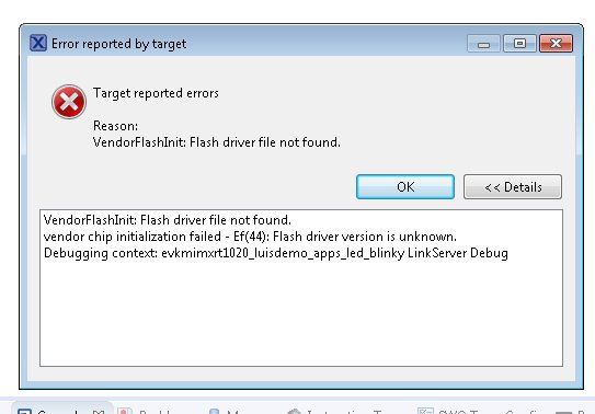

Hello.
I start working with the EVK-MIMXRT1020, I follow all the instructions on the website, I install MCUXpresso, download and install SDK, install USB driver, open Hello_World source code example, Press Build and Debug to program, but it fails. Attached screenshot of MCUXpresso.
I have also reinstalled Java, but it always fails. I also have an evaluation board for the RT1050, and the problem is the same, none can program and run the program, following the instructions on the RT website.

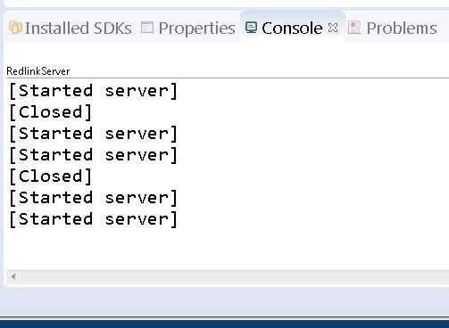

Problem totally solved, and now everything works perfectly. The solution was to simply remove the installation and the directory, and install again but in a NEW directory (in my before tests I always reinstalled in same directory name by default). Therefore, when it is executed from a new directory, the firewall warns about each new process and requests whether to accept the process to grant or not permissions.
Then, after running from a new directory and accepting all the warnings from the firewall, everything works perfectly, Jlink, Multilink and DAP-CMSIS via USB in both versions of MCUXpresso 10.1 and 10.2.
The only thing I did not like, is that NXP at no time they offered help on this problem, not a single suggestion about the problem of a FIREWALL server, and when I knew that the problem came from the firewall they did not give me a solution either to definitely solve the problem.
Thanks to Erich from "MCU on Eclipse" blog, without his suggestion about the firewall, I would not have been able to solve this problem.
These are all messages from the firewall when MCUXpresso is running from a new installation and a new directory, for first time. I accept all the warnings, and in this way, the firewall grants permissions to all the MCUXpresso processes, and everything finally works fine.

MCUXpresso IDE assumes it has localhost telnet access and will request the access it needs from the Windows firewall mechanism. If you make use of a third party firewall, then you will need to manage these requirements.
One thing to point out... if you have multiple installations of MCUXpresso IDE, then each installations copy of LinkServer (Redlinkserv) must have the required firewall access. Our only explanation for the difference in behaviours of versions 10.1 and 10.2 is that at some time in the past, LinkServer from the 10.1 installation had been given the required firewall access.

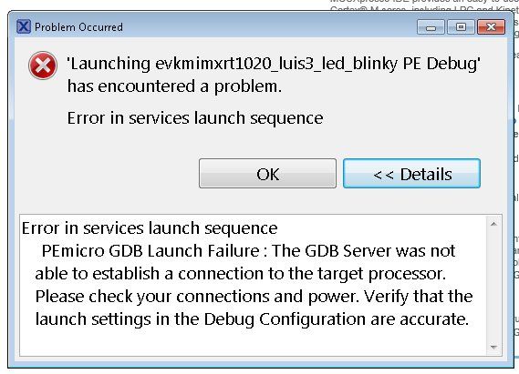

More tests, this with the Multilink PE programmer, fail with MCUXpresso 10.2 if I do not disable the firewall, work well if I disable the firewall. With MCUXpresso 10.1 it works well with or without the firewall enabled.
SEGGER Jlink programmer is currently working perfectly with MCUXpresso 10.1 and 10.2, after giving firewall permissions to Redlinkserv process.  DAP-CMSIS by USB, works perfectly with MCUXpresso 10.1 and gives some errors in MCUXpresso 10.2 if the firewall is enabled, although if I  press OK to the two errors it gives, it seems to work.
In summary, all the current problems have some relation with the firewall and the ports, but only with MCUXpresso 10.2,  no problems with MCUXpresso 10.1.

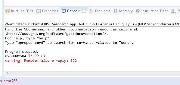

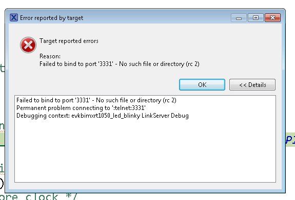

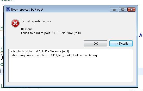

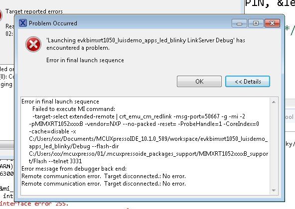

It's strange, now with MCUXpresso 10.1, it does not give any errors and everything works fine. I only get that error from port 3331 with MCUXpresso 10.2, although if I press OK on both errors, it continues and it works. Anyway I would like to eliminate that error.
to bind to port ‘3331’ – No such file or directory (rc 2)
problem connecting to ‘:telnet:3331’
problem connecting to ‘:telnet:3331’ “

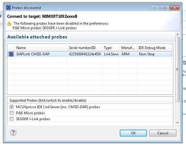

Finally, I think I solved the problem with DAP-CMSIS using a USB driver, although only partially. Erich from the blog "MCU in Eclipse" suggested me to disable the firewall, and indeed, that was the problem, the firewall.
I disabled it and it started to work, but if I activated it again, I lost access again. Then I opened the firewall and gave access permission to "Redlinkserv" as seen in the screenshot attached. In this way it starts, but it gives me two errors, although if I press the OK button on both, it continues and starts without problems.
The question now is how to avoid receiving those error messages, it is something of the firewall, because if I disable it, everything works fine, and if I activate it, although I have already given permission "Redlinkserv", I get those errors that seem related to the port 3331 of the firewall.

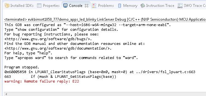

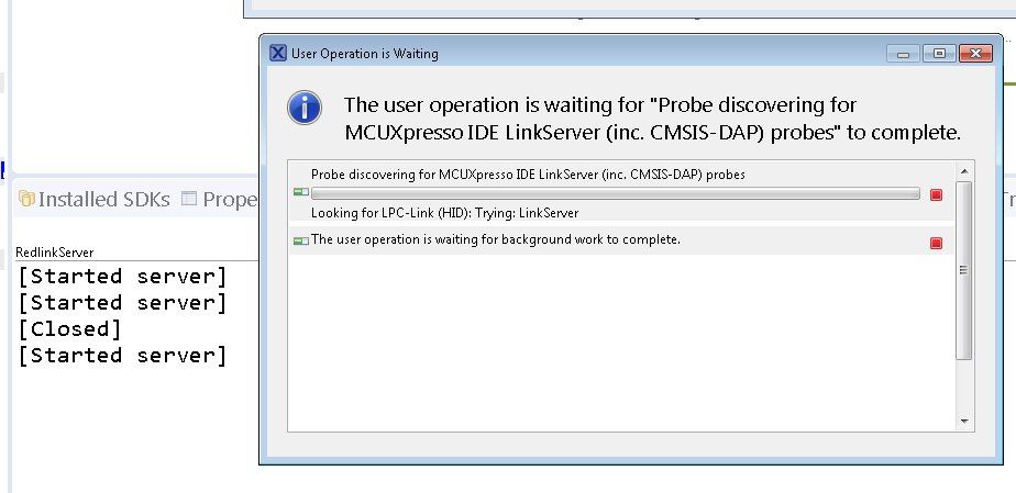

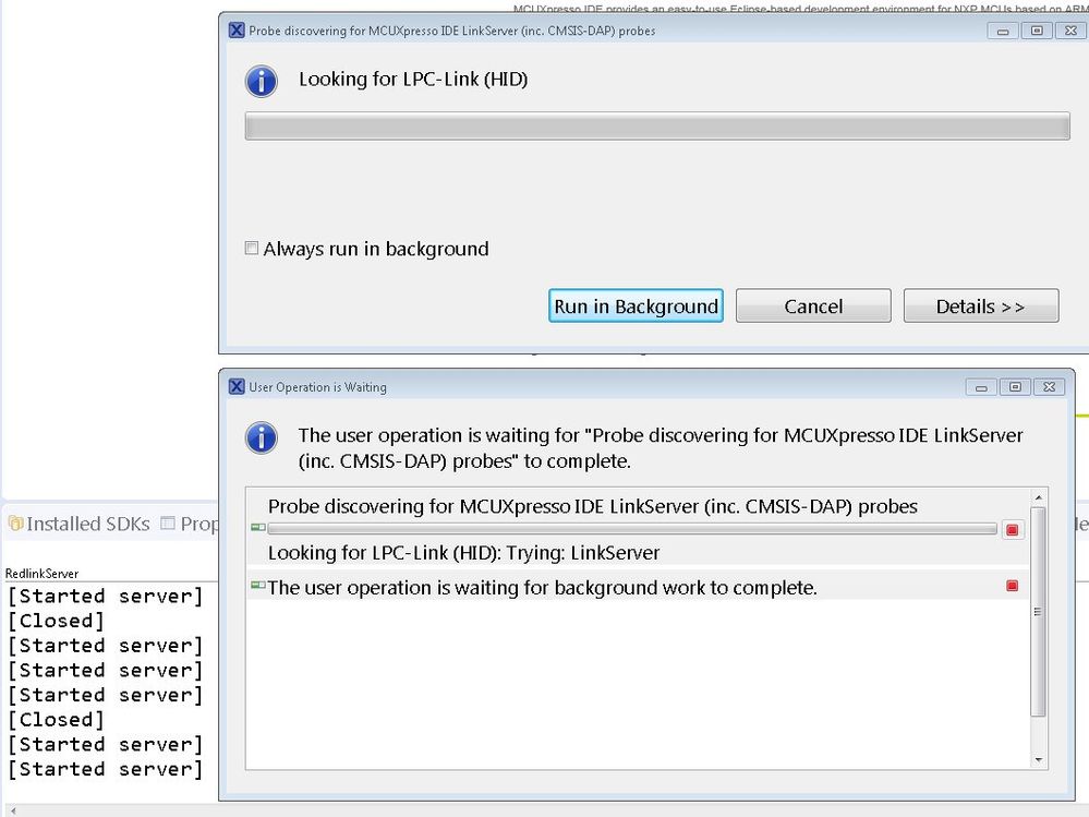

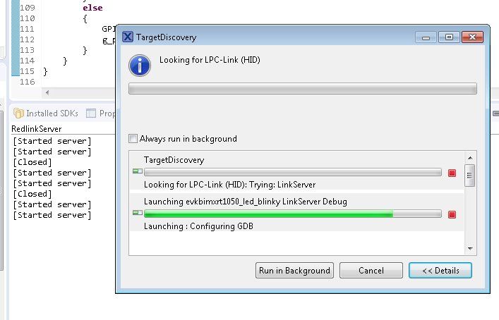

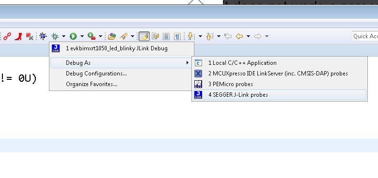

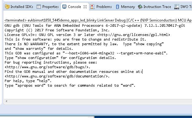

Today I have done more tests and it seems that something has advanced. I already did a completely new installation, deleting the MCUXpresso and the SDK, to install them again, and the failures remained the same, this did not solve anything.
What I saw, is that there are two icons of Debug, one with a violet cockroach, and another with a green cockroach. With the second, I can choose the interface that will be used to make Debug, I get options for CMSIS-DAP, Jlink and Multilink. Over here I have finally been able to start the Debug using Jlink or Multilink in MCUXpresso 10.2. If I use the icon of the violet cockroach, it does not work, a screen appears in which it seems that it is permanently looking for the USB CMSIS-DAP interface, which never finds it.

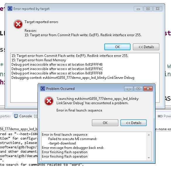

In summary, Debug definitely does not work for me using CMSIS-DAP via USB, in none of the two versions of MCUXpresso, 10.1 and 10.2, it does not find this interface via USB. I have seen the MCU on Eclipse blog, with the tests on the RT1050 evaluation board, and the only difference I have found is that Erich is using Windows 10, and I use Windows7.
Screenshot, using the icon (green cockroach) that gives the option to choose which interface to use to Debug. With this option, I have finally been able to debug with MCUXpresso 10.2 using the Jlink or Multilink programmers, but it fails if I try to use CMSIS-DAP via USB.
Screenshot, about what I see if I try to debug using CMSIS-DAP via USB, or by clicking on the violet cockroach icon. MCUXpresso remains locked on this screen, it seems that it is looking for a USB device but never finds it. The same happens with MCUXpresso 10.1. I work with Windows 7 64 bits, maybe this is the problem, because I see in the blog "MCU on Eclipse" that they try it with Windows 10. May be the USB drivers you provide are not compatible with Windows 7 64 bit, or something is wrong to work with this OS version using CMSIS-DAP by USB, or the firmware version of OpenSDA on my boards is wrong or outdated and is not compatible with current USB drivers.

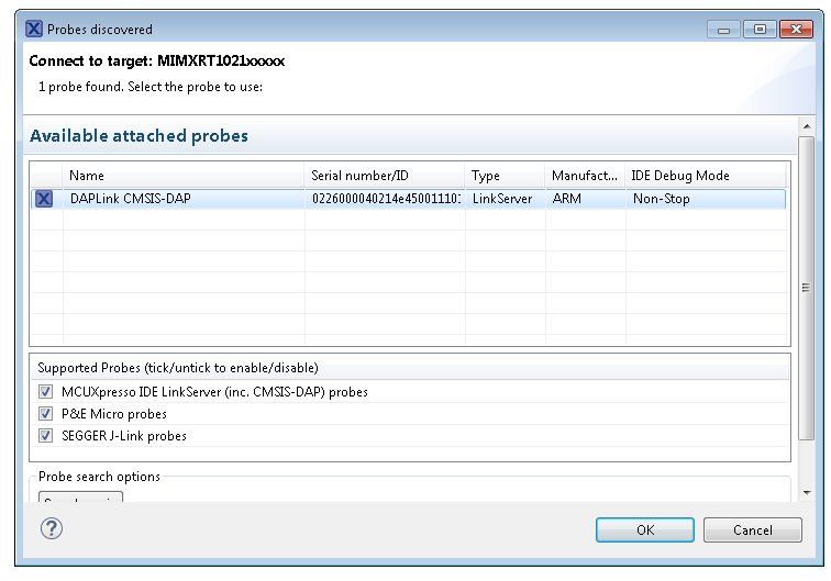

luishs
Senior Contributor I
All that I already did and it continues to fail exactly the same, and only works with the programmers and MCUXpresso version that I have indicated.

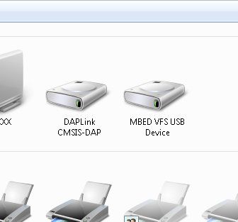

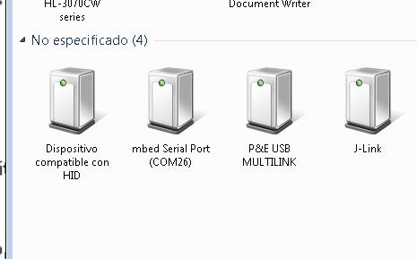

1.- OS ---> Windows 7 64 bit.

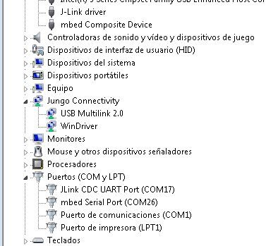

2 .-How the built in debug probe of your RT board appears to your OS in Device and Printers (or similar).
Here you can see Jlink, Multilink and mbed drivers when connect RT1050 by USB
This in Devices and Printers.
3.- Details of any dialogs you see.
Check my before messages, I have post capture screens of all error messages that show MCUXpresso in 10.1 and 10.2 versions.

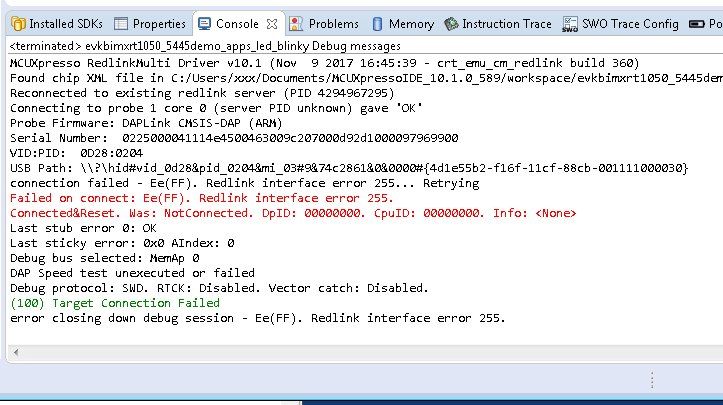

4.- The text content from the Debug Log in the console view. Details of how to get this can be found in section 18.8, "The Console View" of the MCUXpresso IDE v10.2 User Guide.
  4.1.-
  With MCUXpresso 10.1, RT1050 board by USB (DAP LINK CMSIS-DAP Driver)
4.2.- With MCUXpresso 10.2, RT1050 and RT1020 boards.
Tested with Jlink, Multilink and USB (DAP LINK CMSIS-DAP driver). There is no option to choose a different console mode because MCUXpresso remains locked looking for programmers or USB card, and never finds anything, finally I must cancel. With MCUXpresso 10.2 everything fails, Jlink; Multilink and USB (DAP LINK CMSIS-DAP driver), impossible to do anything with this version of MCUXpresso.

Its working in Administrator mode, and fail. Today I have check my RT1020 and RT1050 boards, with MCUxpresso 10.1 and 10.2, programmers Jlink and Multilink, also tested by USB with DAP LINK CMSIS-DAP Driver.
Only works RT1050 + Jlink or Multilink PE  + MCUXpresso 10.1, and RT1020 + Jlink  + MCUXpresso 10.1
RT1050 + MCUxpresso 10.1.0 + DAP LINK CMSIS-DAP Driver --> FAIL
RT1050 + MCUxpresso 10.2.0 + DAP LINK CMSIS-DAP Driver --> FAIL
RT1020 + MCUxpresso 10.1.0 + DAP LINK CMSIS-DAP Driver --> FAIL
RT1020 + MCUxpresso 10.2.0 + DAP LINK CMSIS-DAP Driver --> FAIL
RT1050 + MCUxpresso 10.1.0 + Multilink PE programmer --> OK
RT1050 + MCUxpresso 10.2.0 + Multilink PE programmer --> FAIL
RT1020 + MCUxpresso 10.1.0 + Multilink PE programmer --> FAIL
RT1020 + MCUxpresso 10.2.0 + Multilink PE programmer --> FAIL
RT1050 + MCUxpresso 10.1.0 + Jlink programmer --> OK
RT1050 + MCUxpresso 10.2.0 + Jlink programmer --> FAIL
RT1020 + MCUxpresso 10.1.0 + Jlink programmer --> OK
RT1020 + MCUxpresso 10.2.0 + Jlink programmer --> FAIL
2,172 Views
luishs
I have install now MCUxpresso 10.1.0, and this recognize the DAP Link CMSIS DAP driver, Program, Run and Debug.
But fail with MCUxpresso 10.2.0. What happen, what is the problem with MCUxpresso 10.2.0 ??
