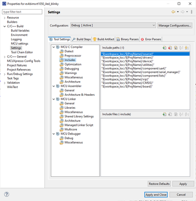

I am running the demo example successfully, but when I am trying to run my own model, I am facing this issue. Also, when I am running the code on another platform on Ubuntu, I am not able to get these files, which are shown in error. Facing this issue for the last 3 weeks after even after trying every method

I saw that you are using a Vosk  model based on Kaldi. But seems that we do not have integration guidelines available. I am sorry for the trouble. I look to undefined references to some source files related to vosk. Have you tried to manually link your source files using the MCUXpresso IDE? For example
