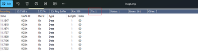

Hello community,
I am using i.MXRT1176 processor and I am using MATLAB 2021b with NXP MBDT version 1.3 for RT MCU. I am working with the CAN bus in transfer mode. I am having a callback function that works perfectly fine until I send a packet in the CAN using a PCAN. When I send the CAN message the CAN bus freezes and in the CAN bus I see an OVERRUN status. I have attached the code and the image of the PCAN window as well

Hi @rithic ,
From your PCAN window, we can see PCAN just send 1 CAN frame data to MIMXRT1176-EVKB board, then MIMXRT1176 project got OVERRUN status.
1: I suggest you check whether your  flexcan_callback  function responds and processes the received CAN frame data promptly and efficiently. I think it is very important.
2:I also suggest you to check whether there are other tasks or interrupts in your project that are consuming a large of CPU time, It  may prevent the CAN receive interrupt from responding promptly.  Please try to optimize the processing time.
3: I think you can do validation on your side, set MIMXRT1176 project only receive CAN frame data , do not send CAN frame data, then check whether the project still got overrun error.
Wish it helps you.

Hi @mayliu1
Thanks for your message. The Issue I identified was with the timing configured in the BUS. Now its working fine without any issues
