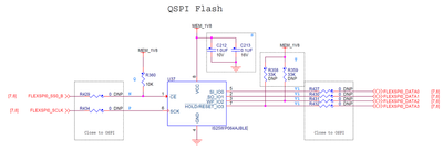

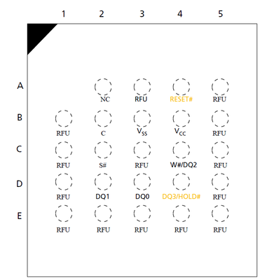

I am using a costume board RT595 and the flash I am using is MT25QU512ABB, in my costume board I configured my board's ISP mode to be working in flexspi mode, and can't change it, so the main issue is that the memory is not detected. Even though,  if I make mcu to program from RAM, it will work fine, so the issue is with the flash, not the hardware connection. furthermore, I am concerned about the MT25QU512ABB extra pin compared with the default QSPI flash memory on the evaluation board S25WP064AJBLE, will it affect the functionality of the flash or will it not change anything?
I tried changing the FCB by following the procedure provided in the documentation of AN13304 nothing changed, also the error that I'm facing is as you can see below:

would you be able to provide an schematic capture of your  implementation ? I want to see what you mean by the extra pin and the flexSPI and DQS connections you made on your design.
Diego.

I can't provide the schematic, but the connection of the MT25QU512ABB flash is from T17 to N12, the QSPI (S25WP064AJBLE) flash connection in your evaluation board is from T17 to R12 so the extra pin that I added is the reset pin. the pictures that I provided can help you in understanding my case.
the connections are:
SCLK ---> T17
CS_L ---> U16
DQ0 ---> T15
DQ1 ---> T14
DQ2(W_L) ---> R13
DQ3(HOLD_L) ---> R12
RESET_L (The extra pin in my case) ---> N12
Vcc ---> 1.8V, Vss ---> GND.
The supplied voltage to the chip and the pull ups is _MCU_A01V8.

I see that your problem is that the reset pin of the micron flahsh you are using is not shared with HOLD and DQ3. Have you tried to connect it to the MCUs POR_B reset pin?
