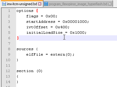

Fan_xy
Hi igor,
I check the BD file imx-itcm-unsigned.bd (AN12107 mentioned) "imx-itcm-unsigned.bd" ,
the IVT address is 0x1400, the entry is 0x2000, they are all ITCM address.
So I was wondering  what relationship with SD card.
fan
3,222 Views
igorpadykov
Hi fan
actually this BD file does not have relation to read boot process,
this relates to *.bd files description, as these files are used elftosb utility.
These bd files are not intuitively understandable, so one can check elftosb documentation.
Suggest to check flashloader documentation.
