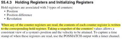

FelipeGarcia
Hi Daniel,
Have you tried using holding registers? Please check below snippet from the RM.
Felipe

dh1
Hi Felipe
Thanks for your reply.
Yes we are using the holding registers.
We use the TRIGGER pin as this is the only pin which allows to copy the current position to the holding registers. But it only allows to react to the rising edge of the signal. We need to be able to react on both edges.
The HOME and INDEX allow to react on both edges, but they can only reset the current position to 0, not to copy the current position to the holding registers.
We could work around the problem, if we know the "shift value" when the reset to 0 happens. Is there a way to know it?
