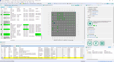

The first thing that needs to be done is to bring the SWO pin to the outside world and make this available to the onboard JTAG adapter. This requires a change to the pin MUX configuration for the single wire debug function [Pad G13] on the RT1060 device.
You can do this using one of two options:
Option 1: Using the MCUXpresso Pins configuration tool and then use the update option to insert the code automatically as follows:
* TEXT BELOW IS USED AS SETTING FOR TOOLS ****************************
CopiedFunction:
- options: {}
- pin_list:
- pinItem: {pin_num: G13, peripheral: ARM, signal: arm_trace_swo, pin_signal: GPIO_AD_B0_10, pull_up_down_config: Pull_Down_100K_Ohm, pull_keeper_select: Keeper,pull_keeper_enable: Disable, open_drain: Disable, speed: MHZ_200, drive_strength: R0_7}
* BE CAREFUL MODIFYING THIS COMMENT - IT IS YAML SETTINGS FOR TOOLS ***********
Option 2: Manually insert the code below into the BOARD_InitPins() function within the pin_mux.c file to set the pin MUX and route the SWO TRACE function to the pin:

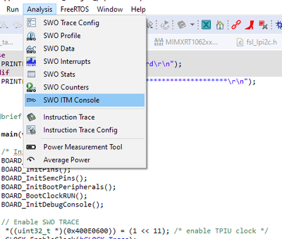

Configuring MCUXpresso for SWO ITM Console trace output
With MCUXpresso the Analysis menu gives access to the advanced trace windows for the IDE:

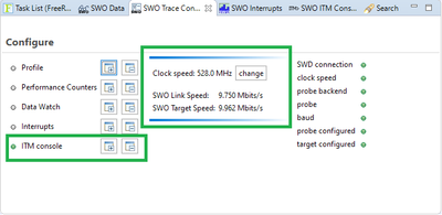

First the SWO Trace Config needs to be configured to detect the link speed and add the ITM Console.  You may need to detect the SWO link by clicking Change -> Detect :
If you select the SWO ITM Console and start the ITM Trace, then allow the debugger to run then you should see the trace output appear:
Note you can stop and start the SWO trace without impacting the performance of the target application. You can even capture and save the ITM Trace Console contents to a file.

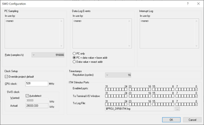

Similarly, if you are using J-Link with IAR then the i.MX RT1060 setup below can be used to emit the SWO trace data in real time and be viewed through the Terminal IO window and also logged to the local file ITM.log.
Note the default CPU clock speed of 528MHz.
J-Link -> SWO Configuration:

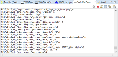

Now it will be possible to enable performance tracing from a Storyboard application which emits PERF data to STDOUT and now have this streamed out of the SWO ITM Console:
Void
sbengine_main_task(void *arg) {
         char *args[20];
         int n = 0;
         // args[n++] = "screen_mgr";
         // args[n++] = "fps";
        args[n++] = "logger";
        args[n++] = "perf=1";
The same can be done for Storyboard debug output by elevating the trace verbosity:
