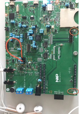

  JP7-1 <--> JP8-2, please double check your board, do you connect it right?
 Why you connect JP7-1 to JP7-2, and JP8-1 to JP8-2?
This is my board connection:
Your connection is totally wrong, please double read the readme.txt, and check your connection, thanks.

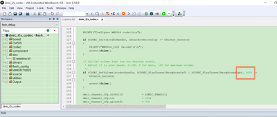

Then try it again, you will can hear the sound through j4, please note the code:
if (CODEC_SetVolume(&codecHandle, kCODEC_PlayChannelHeadphoneLeft | kCODEC_PlayChannelHeadphoneRight, 90U) !=
kStatus_Success)
assert(false);
then build the code and download it.
If you still not work, let me know.
Kerry

If you can't hear it clearly, please modify the codec volume:

To make example work, connections needed to be as follows:
JP7-1 <--> JP8-2

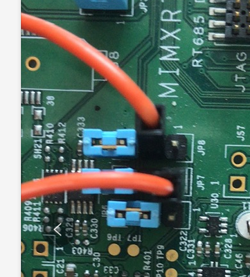

Here I'm attaching photo of setting  JP7-1 <--> JP8-2
pls re-verify it once.

u_h
Thank you kerry
Yes, I made a wrong connection, I would have thought middle pin is for I/P that's why I connect as JP7-1 to JP7-2, and JP8-1 to JP8-2.
