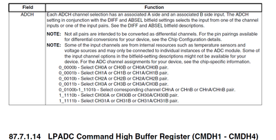

But we wanted to configure both channel A and channel B as single ended modes operating independently. Can you please suggest what is code modification required to make it operate independently.
As shown in the below adc driver file always its entering the IF condition block. but we wanted to use the ELIF condition to select  "kLPADC_SampleChannelDualSingleEndBothSide" to make A and B channel operate independently.

The RT1170 ADC does not support dual single-ended modes, only single-ended and differential modes.
The driver used is publicly reusable, and the RT1170 skips this dual single-ended mode in the code with a conditional compilation instruction.
Specifically, that is:
/* @brief Has conversion type select (bitfield CMDLn[CTYPE]). */
#define FSL_FEATURE_LPADC_HAS_CMDL_CTYPE (0)
As you can see in the RM, the CMDLn register does not have the bit CTYPE:
As an example, use another ADC that supports three sampling modes, such as (MCXN947), which supports single-ended, differential, and dual single-ended modes:
I hope this helps.
